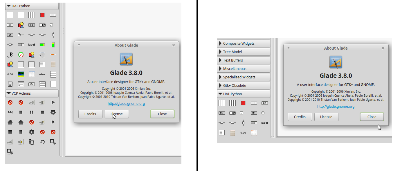

Hi cncnoob1979,
Did you have any trouble also getting the VCP Actions to show up in Glade?
When I tried Mint 18.1 -32bit I noticed there were missing items with LinucCNC 2.7.8 vs when I used the LinuxCNC 2.7.4 package I created about 6 months ago with Mint 17.3.
Could this be purely related to the version of linuxCNC?
I switched back to Mint 17.3 -64bit and got the results in the attached screenshot.
The left image is with Linuxcnc 2.7.4, and the right is 2.7.8.
Just trying to be sure I've got this setup correctly before I set off to learn about Glade!

something is not right there.
if you load glade from the terminal there may be an error message.
It will be hard to find as there are a lot of warnings about icons that are really just noise.
Chris M

Hey! I get all the HAL and VCP Actions as you have shown in the 2.7.4 image.
Something's going on there as Chris M. Pointed out. Have you tried looking at the files to see if they are the same?
Perhaps check for permission issues?
You Could try to launch in a terminal with sudo to verify permission issues.
Before you check for errors make sure to set your terminal buffer to no limit. So you can scroll up, there will be a lot of icons error which are normal.
