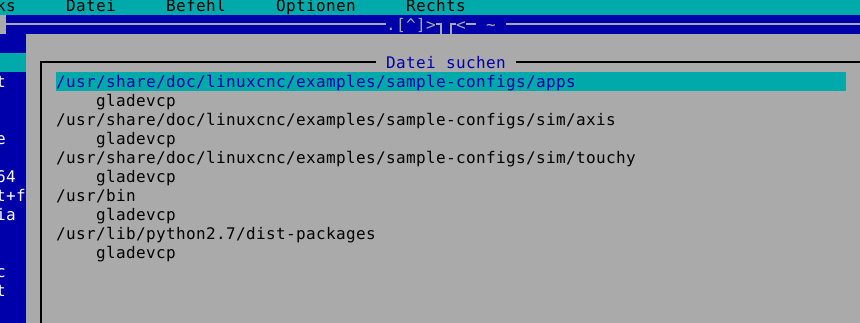

And last I used MC to search the entire system for gladevcp and tried this without success
cnc@MeBigCNC3:~$
cnc@MeBigCNC3:~$ export GLADE_CATALOG_PATH=/usr/lib/python2.7/dist-packages
cnc@MeBigCNC3:~$ linuxcnc_var all
LINUXCNCVERSION=2.8.0-pre1-3575-g8ca6b52eb
LINUXCNC_AUX_GLADEVCP=/usr/share/linuxcnc/aux_gladevcp
LINUXCNC_AUX_EXAMPLES=/usr/share/linuxcnc/aux_examples
REALTIME=/etc/init.d/realtime
RTS=uspace
HALLIB_DIR=/usr/share/linuxcnc/hallib
cnc@MeBigCNC3:~$ export GLADE_CATALOG_PATH="/usr/lib/python2.7/dist-packages"
RTS=uspace
cnc@MeBigCNC3:~$
THX a lot for your patience
