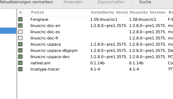

First i installed via iso the newest stretch based 2.7 version
Then i setup things like my touch screen, etc...
Then i changed in synaptic to master 2.8
Got gmoccapy runing.
Then i got running 7i76e, later 7i73. Also with your help of your project files.
Constructed the hw to have my hw-panel so i have real signals connected.

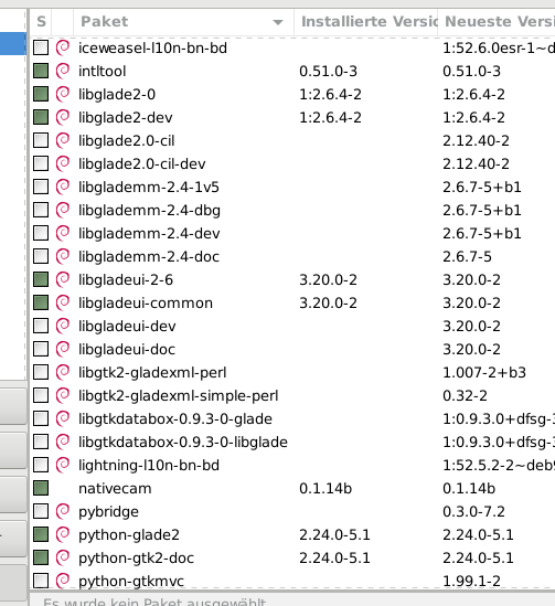

Then i made the mistake to install (synaptic) glade 3.20 and the journey started.
Got hints from chris and you. Deinstalled(syn.) Glade3.20 controlled everything else is working.
Followed #99607 by copy paste. ( Never as root and i never start linuxcnc as linuxcnc-dev!
Stopped following your scrpt on the part where glade-3 command did not run !
I never goon when an instruction is showing an error, never know what i might spoil.
( I have the impression that your script is from that part on a installation of linuxcnc that is not yet on the disk)
In short:
I followed #99607 till 1. glade-3 command. Always as user cnc.
I always copy past your writing into my terminal, never adapt any letter!
My feeling i that i have remains from 3.20 and also some misspointed environment.

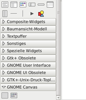

please open glade-3 from a terminal, check if you can see the hal widgets. (two Icon groups left side most down, in my case they are named HAL Python and VCP Actions.
If they are there, all is working as it should.
If not, please do

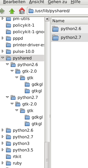

That file should be in /usr/lib/pymodules/python2.7/gladevcp
and I have it also in /usr/share/pyshared/gladevcp
report
Norbert

by Mike_Eitel
Replied by Mike_Eitel on topic Glade 3.8.3
W O W
What a big difference !
Now I have the additional widgets. And I can open your gmoccapy.glade
NO ERRORS and i can see contend !
THX for your patience Norbert
P.S.
Yes I had to copy the files as root to usr/local.....
P.S.
