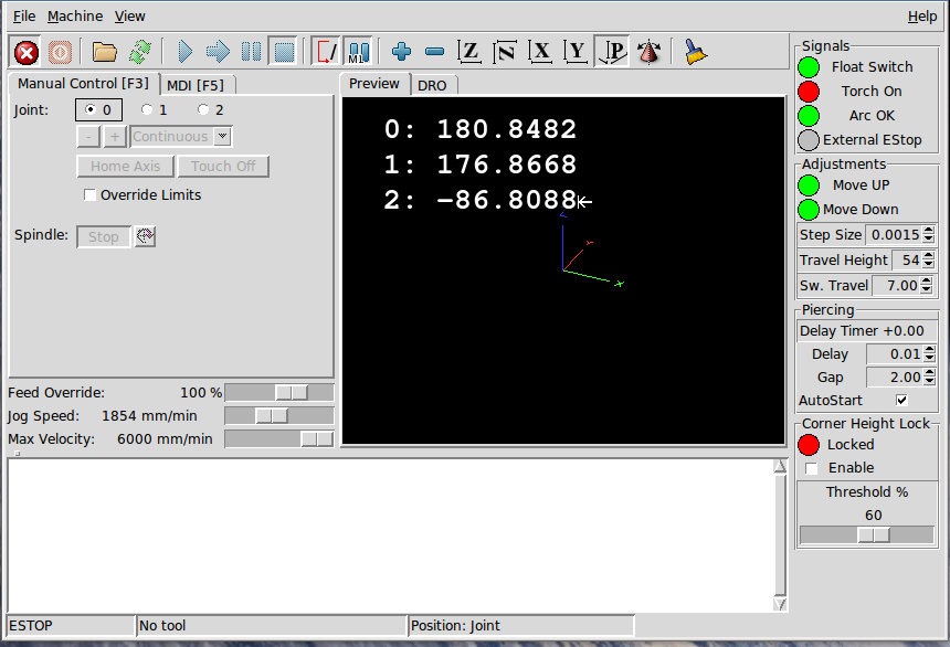

The axis indicates numbers since it is in "Joint Mode" so if you go to "view->world mode" it will display X Y and Z.

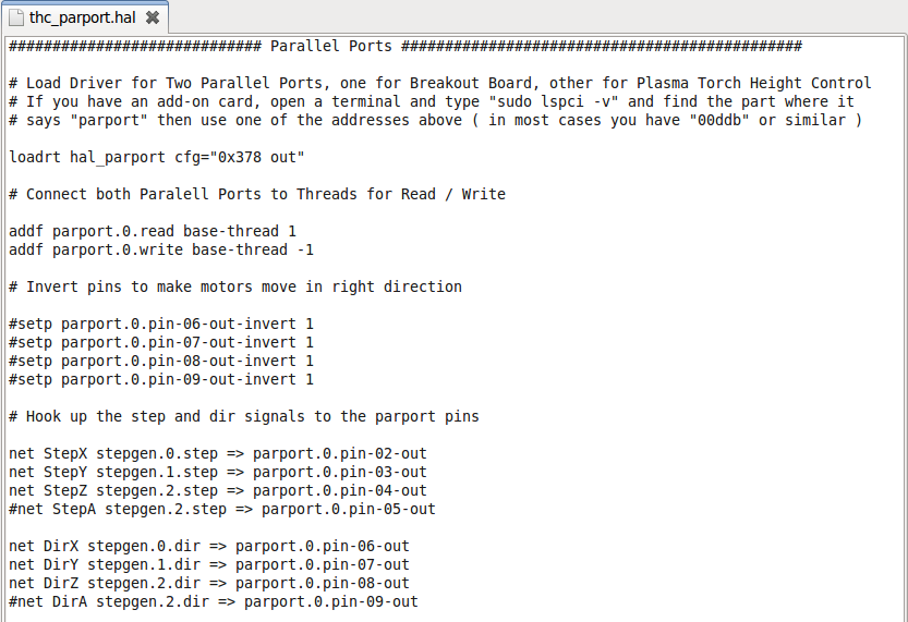

The "thc_parport.hal" has only the outputs for motor controls ( step and direction pins ) with added lines for reverse direction of any of the axes if it need be. There are settings for 4 axes although i use 3. Check your output pins and edit this file.
In the attached picture by BosniaCNC the Z limit switch is active as it is connected to pin 15 on parport and some BOBs give a trigered state on that pin so here are the solutions:
add a limit switch to Z axis,
change "the active" high or "active low" at input 15 on the BOB
open "thc.hal" and search for "limitZ" and just add a "#" in front of it.
that's it. Moving on
Word of advice: since the Z axis has to be decoupled from normal control and the "ferror" or "feed error" has to be higher than usual, DO NOT keep the Z axis jog buttons pressed, do it in short presses or the axis will keep moving after you release the buttons.
