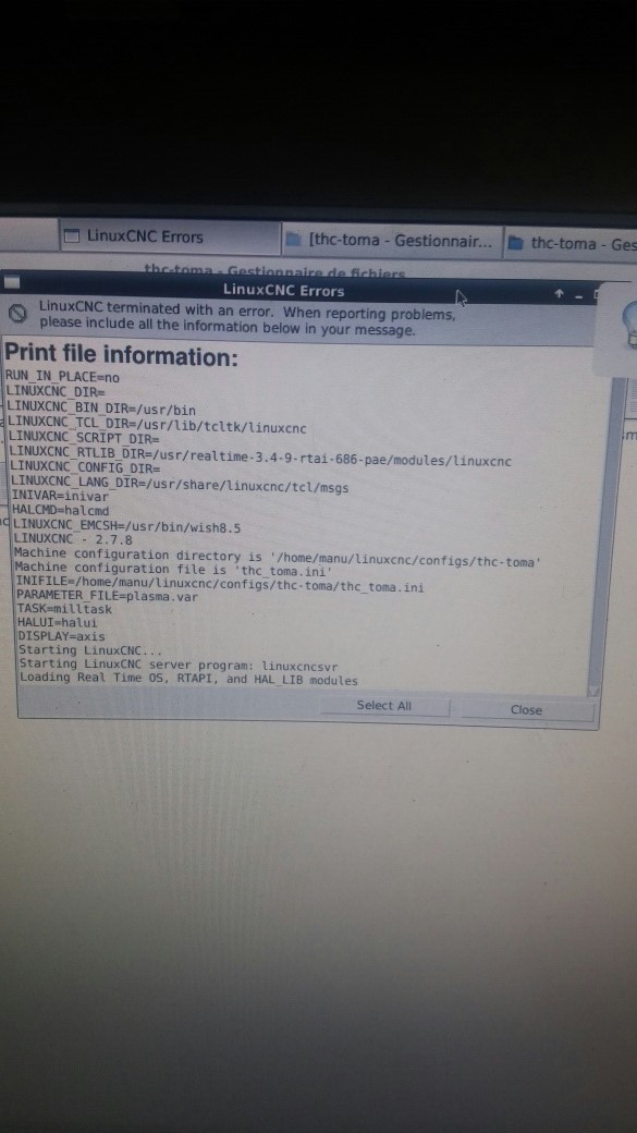

Are you loading an estop-latch component?
You would need to scroll about one page lower down the error listing to see the actual problem.

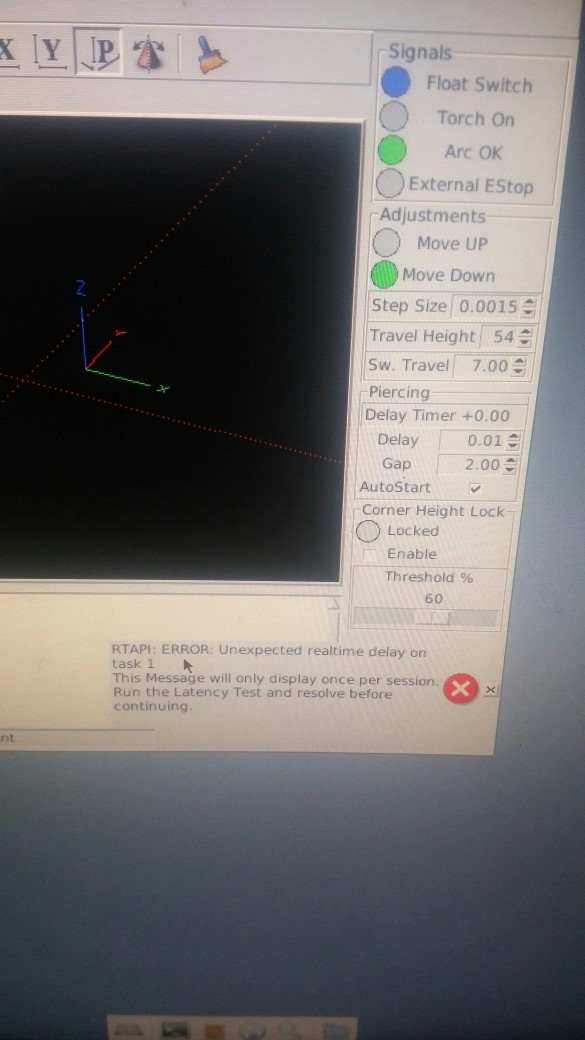

05 Feb 2017 13:05 #87351
Replied by tommylight on topic THC config that works.
That is becouse the pin 15 is already connected in the thc.hal file.
You will have to change the pins in the thc.hal, the input pins for UP/DOWN/ARCOK and Float Switch.
Currently you have only UP set properly, there should be no lights ON when you start Linuxcnc.
There are already setings for IN or IN-NOT depending on the input signals.

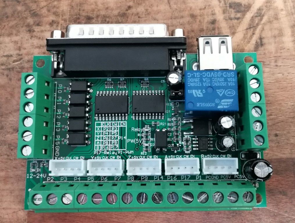

here's my card
When i copy the thc-toma folder into / home / manu / linuxcnc / there is 2 file that does not disappear
In the thc-toma folder there is 2 file thc (thc.hal and thc.hal ~)?
here's my card

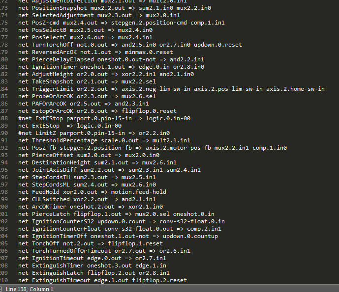

05 Feb 2017 14:17 #87369
You have to change the inputs in the thc.hal file. Leave e-stop as it was originaly. If you change the hal file name, you will have to edit the ini file to point to the new name.
Edit the moveup, movedown, arcok, floatswitch to fit your BOB.
If you have the arcok led on in the panel, it will not let you jog the machine.

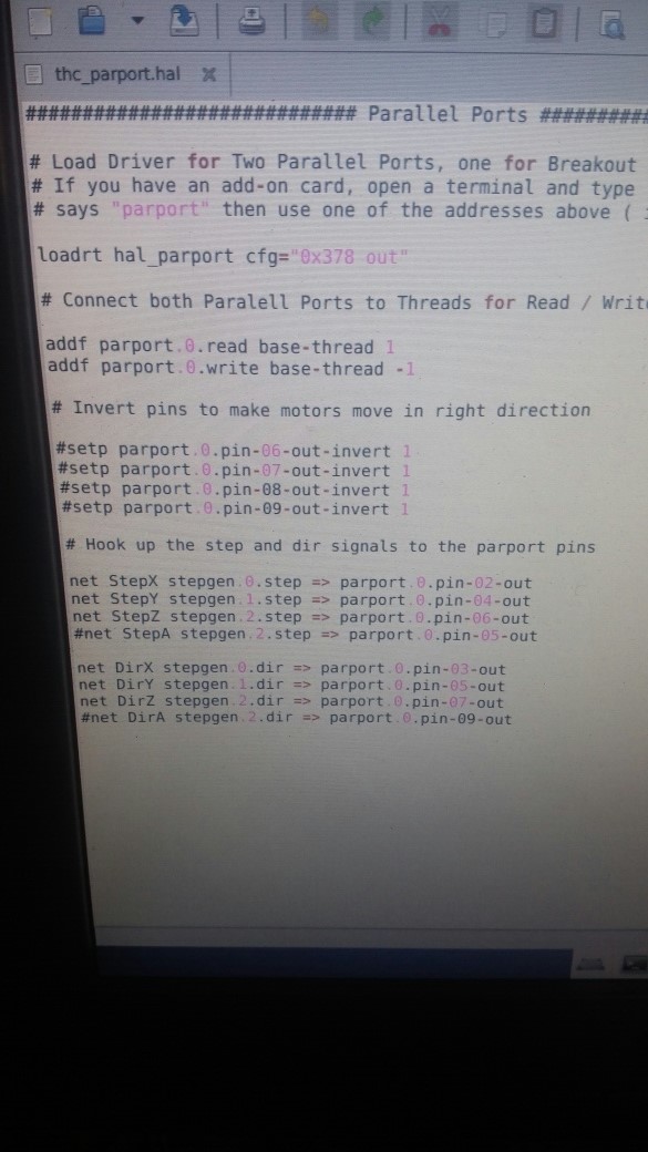

27 Feb 2017 06:10 #88661
by beauxnez
Replied by beauxnez on topic THC config that works.
Hello
By modifying the thc.hal file I managed to run the estop button
I have all my lights off
When pressing the limit switch connect to pin 15 the indicator light does not light
When I try to advance the engine it does not move?
Here is my file modify according to my bob
############################# Parallel Ports ##############################################
# Load Driver for Two Parallel Ports, one for Breakout Board, other for Plasma Torch Height Control
# If you have an add-on card, open a terminal and type "sudo lspci -v" and find the part where it
# says "parport" then use one of the addresses above ( in most cases you have "00ddb" or similar )
# Connect both Paralell Ports to Threads for Read / Write
addf parport.0.read base-thread 1
addf parport.0.write base-thread -1
# Invert pins to make motors move in right direction
#setp parport.0.pin-06-out-invert 1
#setp parport.0.pin-07-out-invert 1
#setp parport.0.pin-08-out-invert 1
#setp parport.0.pin-09-out-invert 1
# Hook up the step and dir signals to the parport pins
net StepX stepgen.0.step => parport.0.pin-02-out
net StepY stepgen.1.step => parport.0.pin-04-out
net StepZ stepgen.2.step => parport.0.pin-06-out
#net StepA stepgen.2.step => parport.0.pin-05-out
net DirX stepgen.0.dir => parport.0.pin-03-out
net DirY stepgen.1.dir => parport.0.pin-05-out
net DirZ stepgen.2.dir => parport.0.pin-07-out
#net DirA stepgen.2.dir => parport.0.pin-09-outPlease Log in or Create an account to join the conversation.
- Posts: 22030
- Thank you received: 7504

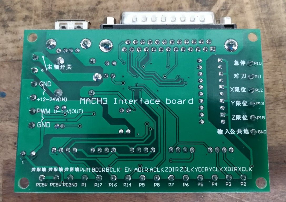

27 Feb 2017 11:26 #88684
Do not change the file names, or if you do change them, change the appropriate entries in the ini file.
And you have the limit switch ( in this case the probe switch ) wired to pin 13 in hal, not pin 15.
