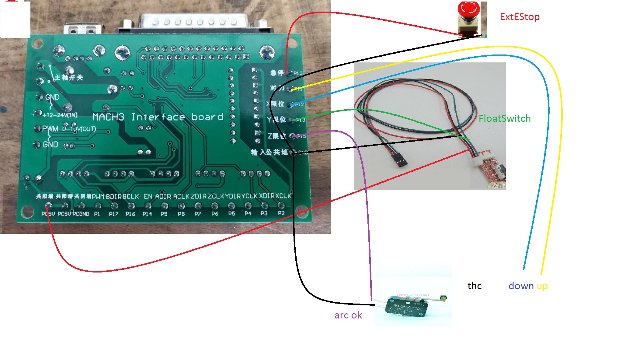

Hello
I modified my michine I got a lot of inspiration from the toma machine
here's mine
www.dropbox.com/s/hhdbuz0drkhinf4/2017-0...%2015.19.11.mp4?dl=0
With the config through step conf ca works perfectly as you can see on the video
I have successfully turned off all the LEDs on the screen, configure the X, Y, Z pins but no engines running with the thc-toma file:angry:
here's mine

In the video the machine is moving, but it will not go further without the ARCOK signal, it waits for the torch to fire. You can wire a switch between gnd and the ARCOK input and activate it by hand after it finds the material.

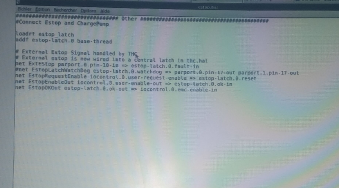

- Posts: 22030
- Thank you received: 7504
16 Apr 2017 14:25 #91470
Replied by tommylight on topic THC config that works.
Did you set the correct "enable" pin in the "e-stop.hal"?

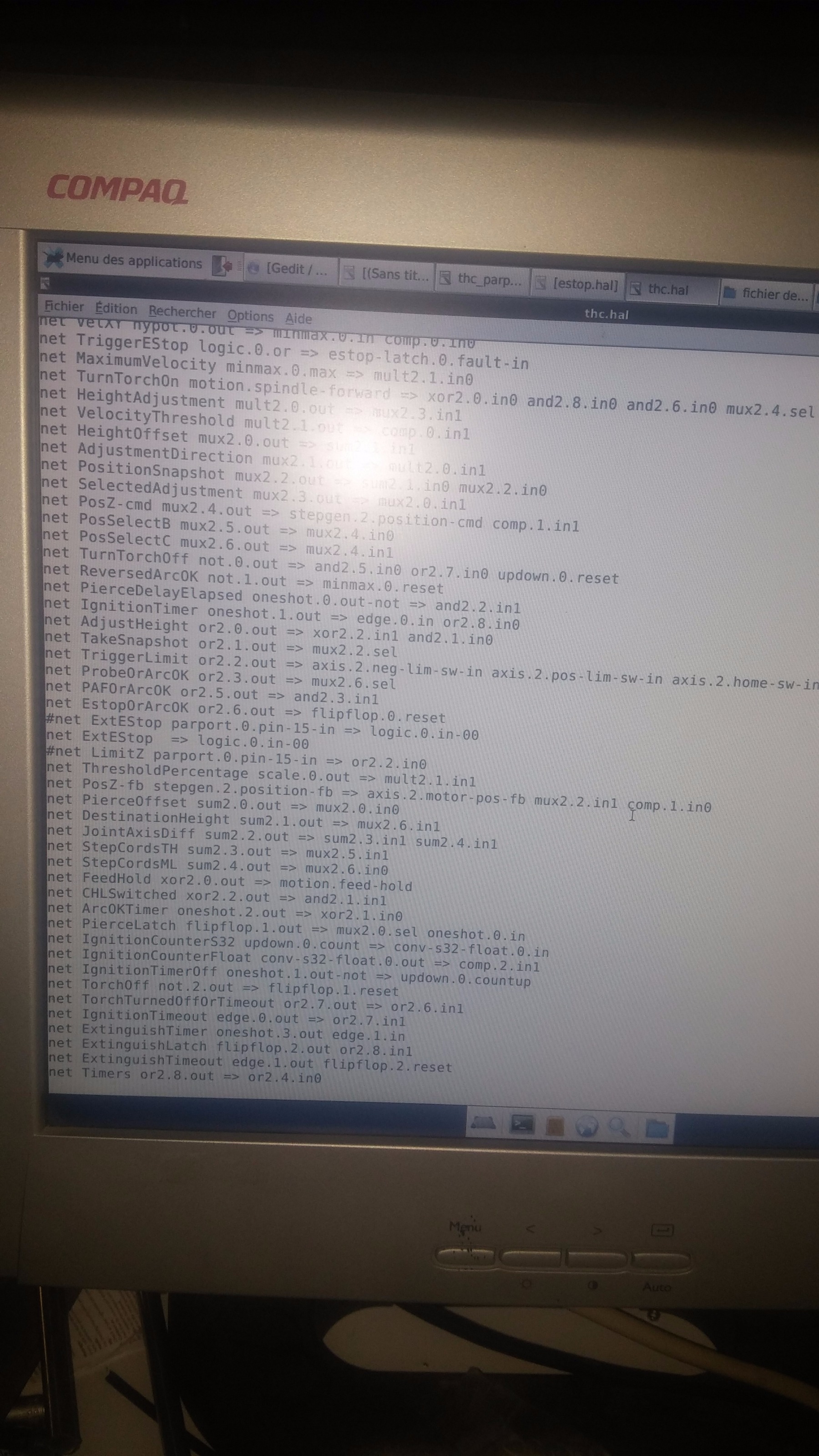

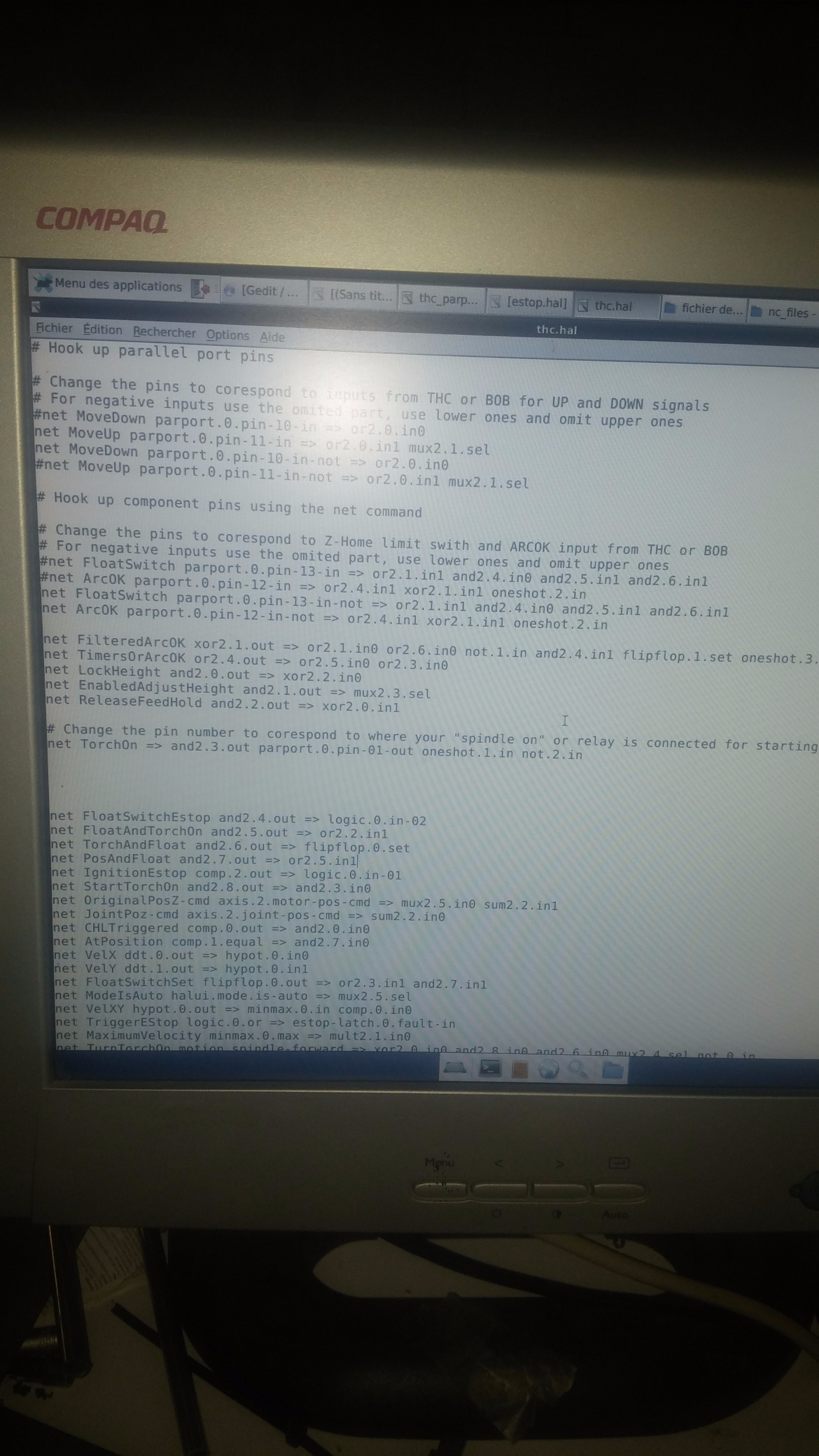

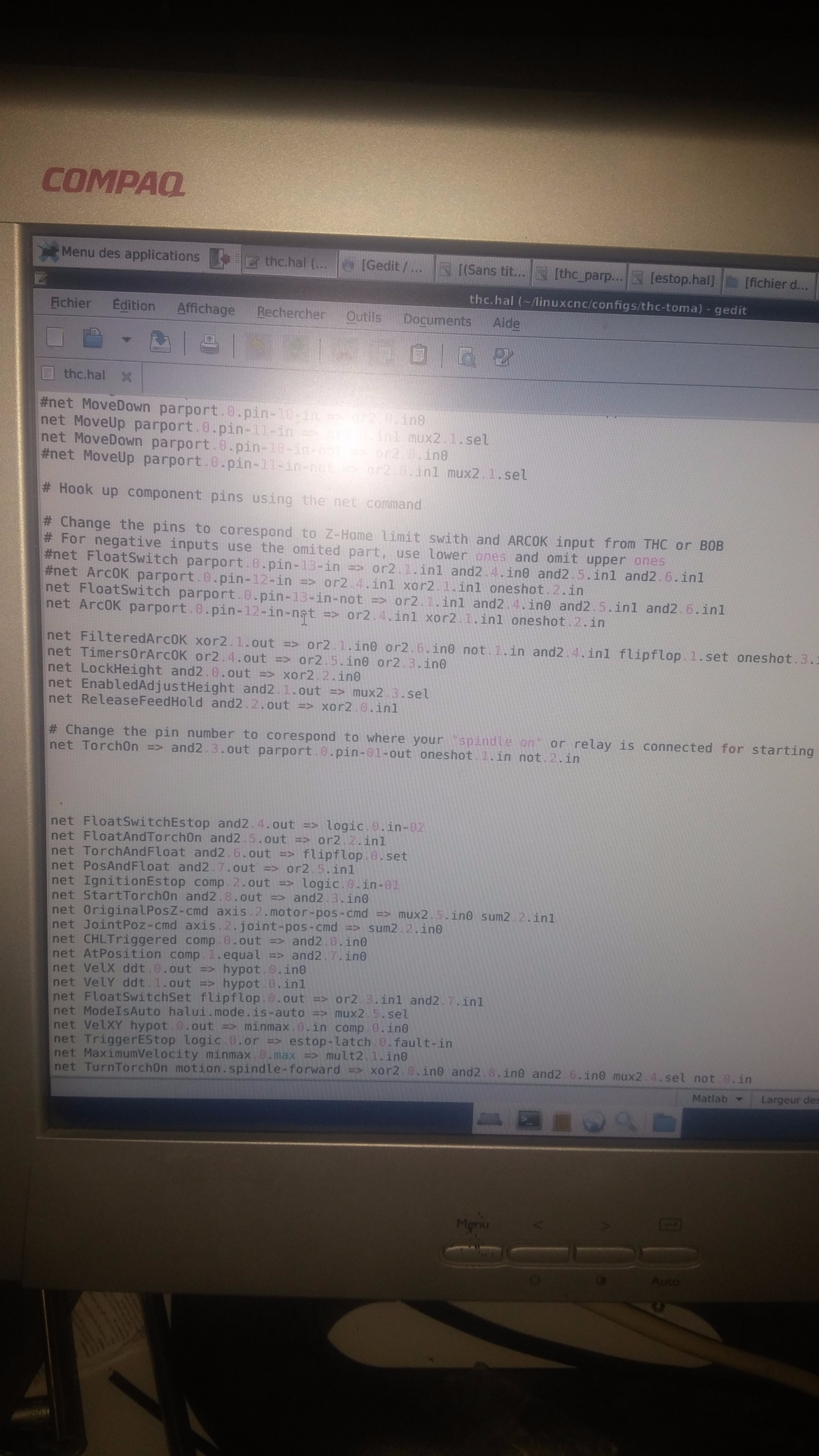

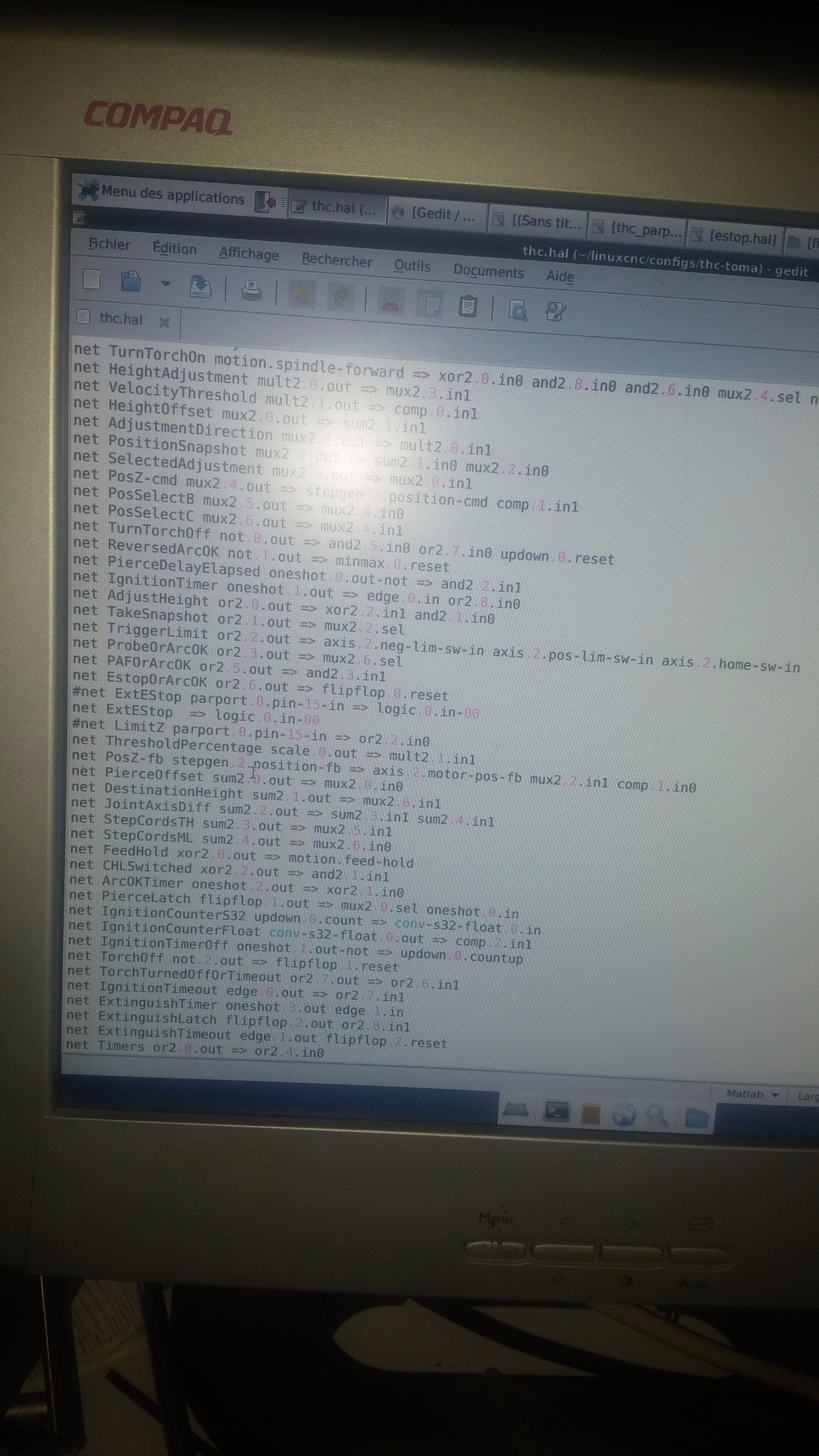

18 Apr 2017 21:46 - 18 Apr 2017 21:47 #91619
by beauxnez
Replied by beauxnez on topic THC config that works.
Last edit: 18 Apr 2017 21:47 by beauxnez.
- Posts: 22030
19 Apr 2017 16:22 #91676
You have to disable the third line not the fourth, third line should be enabled only if you have an external e-stop switch.
If you disable the fourth line, you will have to add another line in the hal file with "xenable" in it and pin 17 of parallel port so it activates the enable on the drives.
- beauxnez
- Posts: 149
- Thank you received: 10
21 Apr 2017 00:07 #91745
by beauxnez

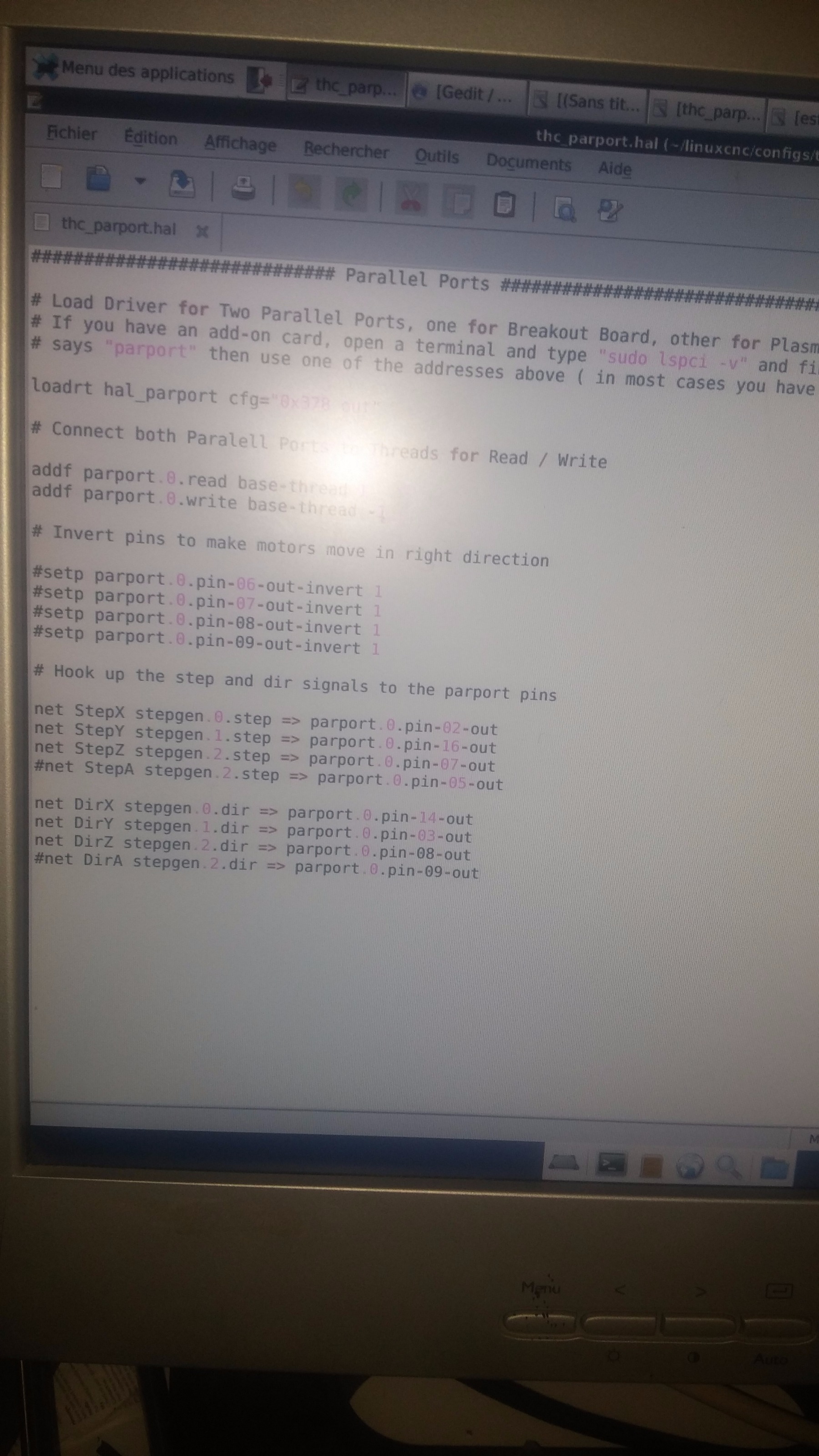

On pin p17 I have the relay plasma, I can put another pin? I connect what on?
- Posts: 22030
21 Apr 2017 07:54 #91778
Pin 1. Also put pin 17 in thc.hal for torch on.
