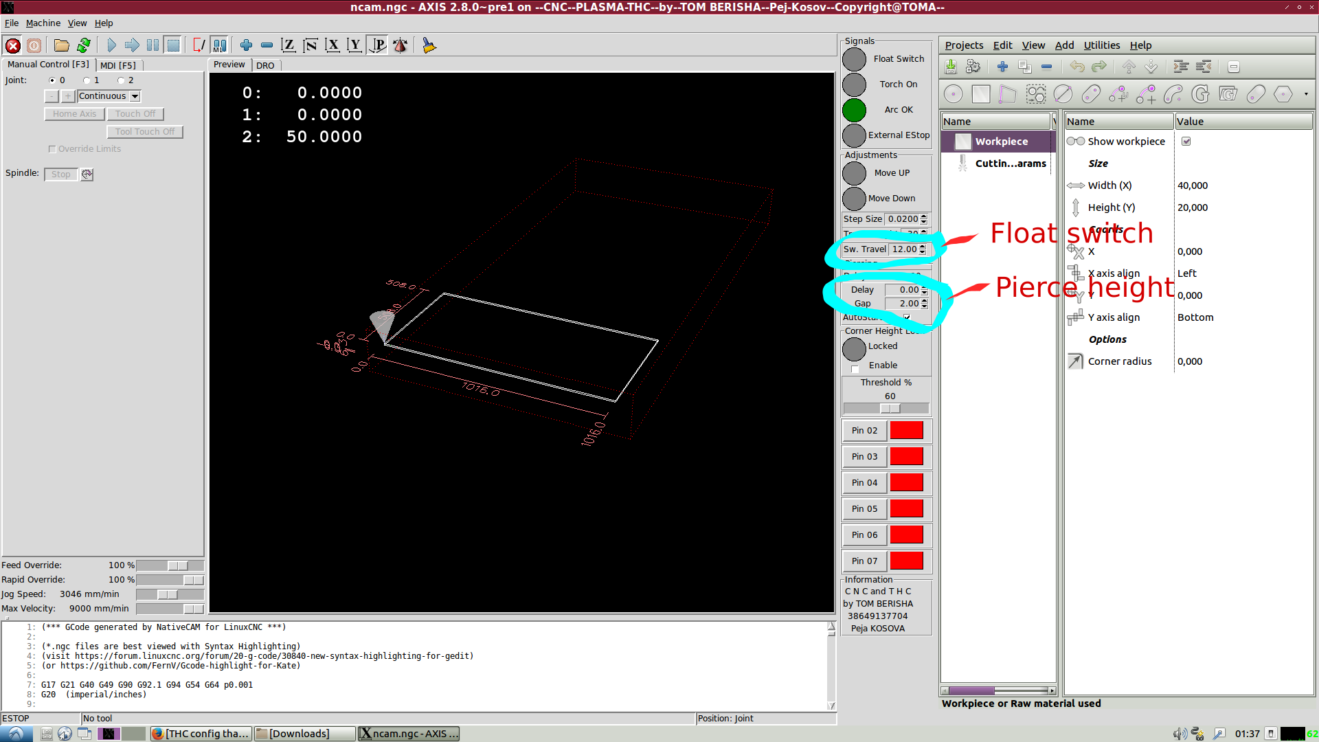

With my plasma, I have to initiate in contact with the tole and then to rise of about 2mm.
With this config I have to modify something in the gcode or in this config?

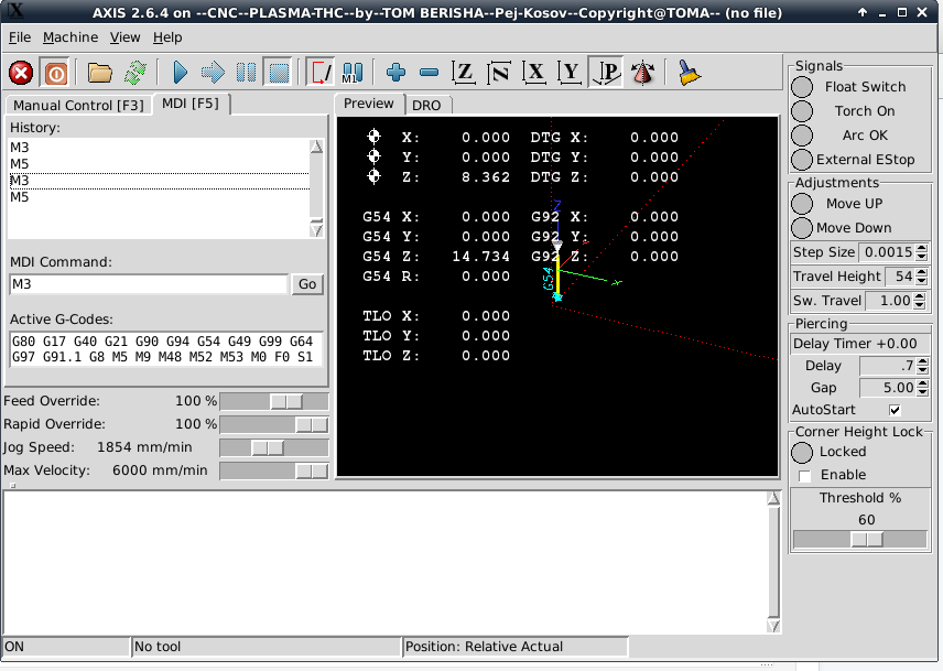

I've just finished my float switch setup and I'm trying to get the initial pierce sequence to work. My switch has 1mm of travel before activate (ie blue float switch indicator comes on). I'm cutting 3/8 mild steel so I've set the initial cut to 5mm and a delay of .7 sec. The z axis will go down, touch off, go to ~8.3 mm, and fire. This is of course to high so it just repeats.
Is there another setting I'm missing? Why does it go to 8.3mm instead of 5mm? Do I have to set something with the touch off button?
I'm a little confused as well on what the sequence is to initiall home the z axis. It seems if it is not high enough it will go down and hit the limit switch which cause a joint 2 error.
Thanks for advance for any help you can provide.
- Posts: 22030
- Thank you received: 7504
21 Jul 2017 01:02 #96208
Replied by tommylight on topic THC config that works.
In the screenshot you have active offsets, so cancel them. Also make sure you have the correct scale for Z axis as that will mess up the height.
