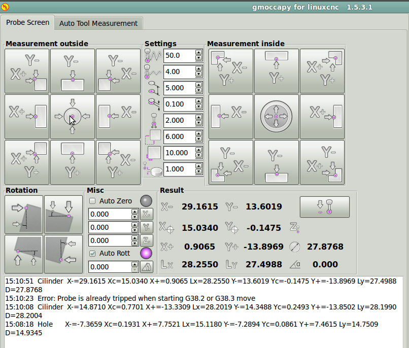

15 Jun 2015 23:28 - 16 Jun 2015 00:09 #59857
by verser
Replied by verser on topic Work with probe
Last edit: 16 Jun 2015 00:09 by verser.

- mariusl
16 Jun 2015 03:18 #59862
by mariusl
Regards
Marius
www.bluearccnc.com
Replied by mariusl on topic Work with probe
Is this new screen on Github yet. I just pulled but it still looks like the older screen.
Regards
Marius
www.bluearccnc.com
