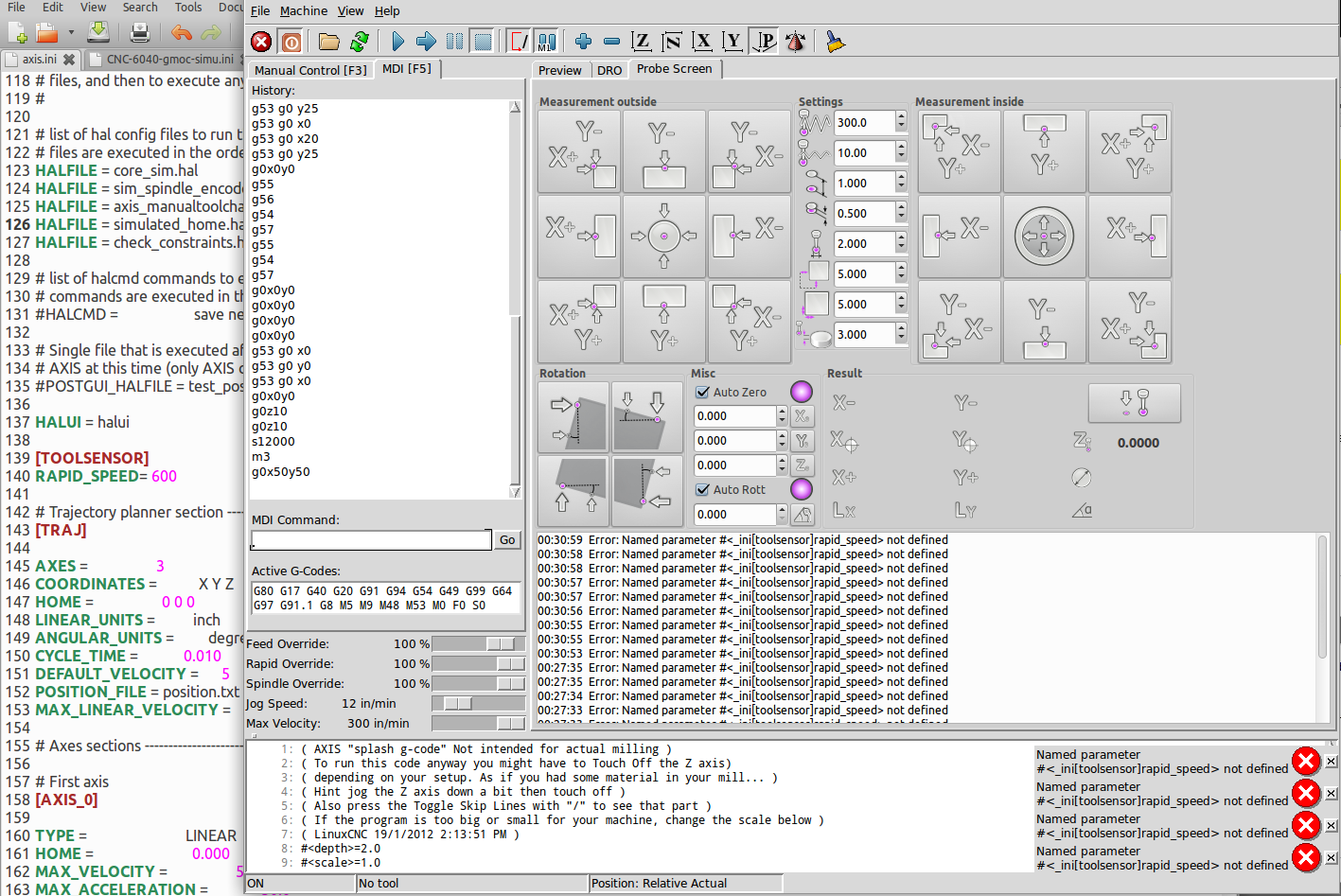

17 Sep 2015 21:34 #62705
by racedirector
Replied by racedirector on topic Work with probe
The famous RAPID_SPEED error has struck... just downloaded from git and installed on the axis sim. Screenshot shows the required entry in the ini DOES exist. Where to from here?
