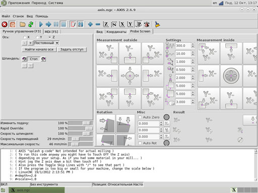

Hi Verser!
Thank you for your work on this nice probe_screen.
I just wanted to give a bit of feedback regarding some minor Bugs in your screen. Maybe that helps to improve your nice work.
I m just testing the version from today from Probe_screen_master
- Measurement outside:
- Tooltip says: "Cilinder" should be "Cylinder"
- Settings:
- The input field of "Search Velocity" has no black Frame. All the other settings do have it.
- Misc:
- "Auto Rott" should be "Auto Rot" as i think Rot is short for Rotation.
- Result:
- The tooltips have a bit of an offset to the right, or should i say the boxes end too far in the right.
For example: if i place cursor over the pictogramm of "Diameter" the tooltip says "Probe Y+ pos."
When i move cursor to the right (and off the pictogramm) it says "Diameter. I hope you know what i mean.
Hope it helps for making it even better.
Have a nice day.
Mathias

Dear community,
I have been playing around with this tool and find it very useful, indeed. However, I am using Axis and are unable to fit the GUI in the available space. It seems to be made static in size and so some of it is hidden and can not be made visible. I tried to redesign it in Glade to make it scalable to fit the available space, or at least introduce scrollbars, but have given up. Are there any Glade wizards out there who know how to do this?
Thanks,
/Chris

I have plans to fix it in the nearest update.
Replied by verser on topic Work with probe
There is such a flaw with displays 1024x768...I am using Axis and are unable to fit the GUI in the available space.
