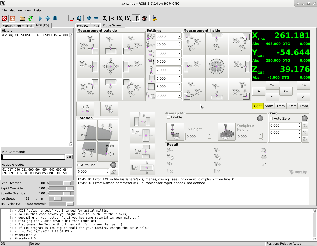

Hello.
I have encountered some problems with probe screen V2 from the very beginning.I have defined the missing variable manually via MDI to try and progress. I was able to work around this issue but a proper solution would be appreciated. I then googled for the next issue and found that removing '%' from nc files could fix it but the problem is there's no '%' in ANY of them!
Is there anyone who can try and help me fix it? Thanks in advance.
LinuxCNC/AXIS version 2.7.14
Cheers,
Bushman
12:45:30 Error: EOF in file:/usr/share/axis/images/axis.ngc seeking o-word: o<xplus> from line: 0
12:45:10 Error: Named parameter #<_ini[toolsensor]rapid_speed> not defined Is there anyone who can try and help me fix it? Thanks in advance.

Replied by andypugh on topic Work with probe
You need to add the entries to the INI file.For example.
You might also need to enable INI file access from G-code:
linuxcnc.org/docs/2.8/html/config/ini-co...sec:rs274ngc-section
[TOOLSENSOR]
RAPID_SPEED = 100You might also need to enable INI file access from G-code:
[RS274NGC]

It is added as per installation instructions.
You think the [RS274NGC] thing might help?
EDIT:
this is already in .ini
EDIT:
[RS274NGC]
FEATURES=30
Last edit: 26 Jun 2019 07:04 by InnerBushman.

After further inspection I've noticed I have doubled the [RS274NGC] section.
I have moved all the entries to the first one and removed the second one.
This has solved the previous issues.
andypugh, thank you for your input.
Unfortunately i've run into another issue. My probe isn't working.
Let me explain: the mechanical probe works just fine, the digital input also...
but for some reason axis no longer reacts to the probe being tripped, neither the probe screen.
My probe is defined in .hal as follows:Complete .hal file:
Any ideas?

You need another "end" to your probe signal.
net probe-in motion.probe-in

andypugh, thanks for your help. I in fact was missing that line in the config.
I have no idea how it got removed since it IS present in the source config which I used (and tested beforehand) for this installation. I have added this line back and the probe is operational again!
The probe screen works like a charm now. Thank you!
