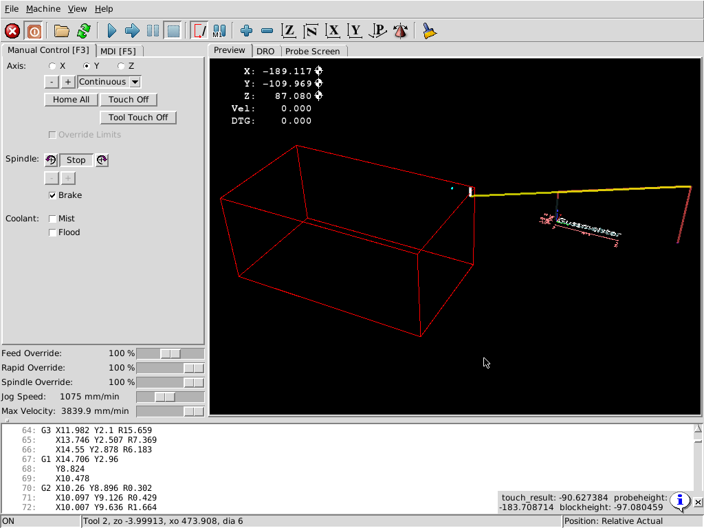

10 Mar 2019 19:56 - 10 Mar 2019 20:00 #128270
by Ferdl
Replied by Ferdl on topic Work with probe
Hi, on problem solved another apears
with the probe screen I can touch off the workpiece, set the zero by auto measurement. The Touch sensor height measurment seams ok.
Then I start my gcode and the M6 manual tool change starts, the tool height measurement works but after the measurement the G54 origin is automatically moved outside my maschine coordinate ? See the picture.
I used a simpler manual tool change height measurement on my old linuxcnc machine. But i did not work with the G10 L20/L2 offset like the Probe Screen V2. I only used the G43.1 to compensate the different tool heights.
Any idea?
Maybe the reason is related to my g-code creator:
Any idea?

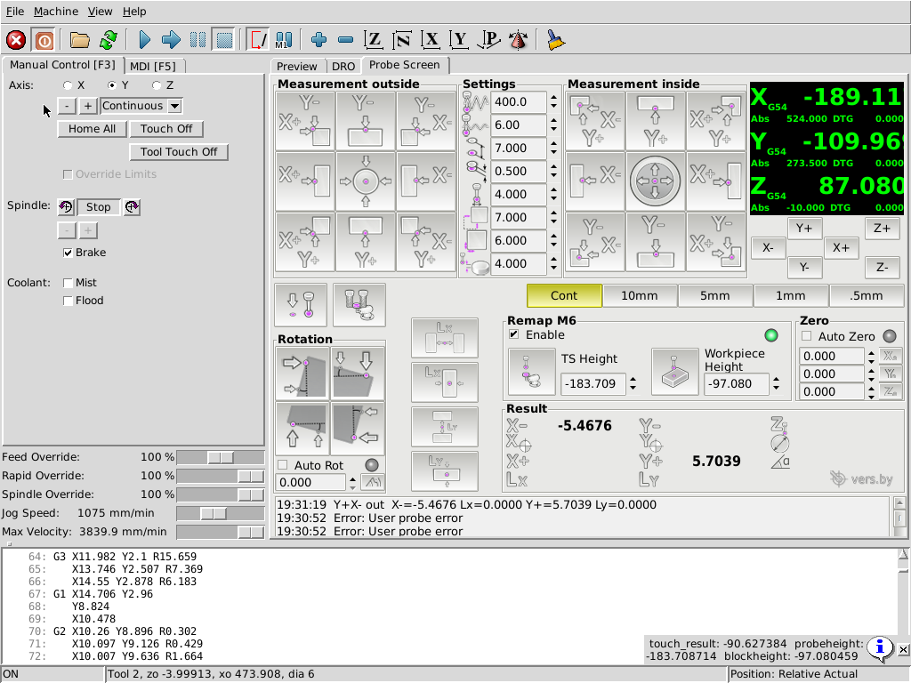

14 Mar 2019 10:02 #128566
by vmihalca
Replied by vmihalca on topic Work with probe
I have noticed that it seems to work if I lower the feedrate at 50%.
Don't know yet if it's a coincidence or not, still have to figure it out.
What I have noticed is that the inside diameter measurement is not accurate or repeatable.
I have measured a ballbearing with inside diameter of 15mm.
The values I got for diameter were 15,21
I have measured the stylus ruby ball and its 1.99mm
and also in the video above, I was measuring a 10mm bore and I got 10.2114.
Any idea where can this come from?
I have made jog tests with a plunge test indicator, and the movements are correct and the backlash is around 0.01.
Also I've multiple X+ and X- measurements and the values are repeatable within 0,01 range.
Any idea where can the 0.2 error come from?
