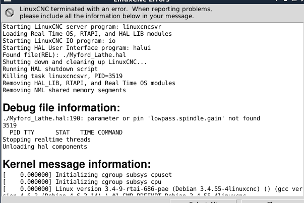

I am trying to setup up a spindle encoder to enable threading I had this working before with a PP but am now trying to configure with the mesa 7i76 I have Linux 2.7.4 using PnCConf I am getting an error message with debug, attached.
I would like to use A + B + index I have connected these to TB3 pins 7,10 and index to 13 on the 7i76
Is this correct and how do I sort the error out?

In the "loadrt" section you need
loadrt scale names=scale.spindlePlease Log in or Create an account to join the conversation.

Andy I have tried that and it gives the error in Debug lowpass.spindle.gain not found
- Posts: 19899
15 Mar 2016 15:30 #71684
Replied by andypugh on topic mesa 7i76 configuring a spindle encoder
loadrt lowpass names=spindle.lowpass

- Posts: 19899
16 Mar 2016 16:27 #71729
See how you have "names=spindle.lowpass" and then the error is "lowpass.spindle.gain, pin not found"
It's my fault, I think, but the fix seems fairly easy.

16 Mar 2016 17:24 #71733
by Clive S
Ok have have changed it to names=lowpass.spindle.gain and still the same error
Replied by Clive S on topic mesa 7i76 configuring a spindle encoder

16 Mar 2016 17:41 #71736
Hmm, comment out that line, then start LinuxCNC
Then open a terminal and type
halcmd -kf
show pin lowpass*
exit
halcmd -kf
show pin lowpass*
exit

16 Mar 2016 18:15 - 16 Mar 2016 18:18 #71738
by Clive S
Thanks for your patience Andy but commenting it out does not let me start LinuxCNC. Tomorrow I will start from scratch with the lathe config and generate a new one. with PnCConf and start again.
its the encoder for the threading I am trying to sort out I am not trying to sort out the spindle speed
