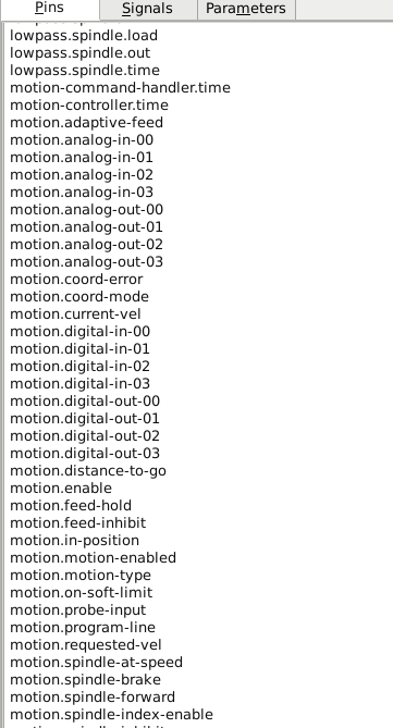

Replied by andypugh on topic mesa 7i76 configuring a spindle encoder
What doesn't work as things are now?
Open a halmeter and look at motion.spindle-revs
If that increases by 1 for one rev of the spindle you are probably all set.

Ok no joy with motion.spindle-revs but the voltage on the index at the 7i76 pin TB3 13 changes from 5V to 0V when the chuck is rotated
edit I am using this as single ended input

quote What is the ...enc0.position pin doing?
Can't seem to find that. Do you think I have it conned ok is there any thing to add in the ini file?

17 Mar 2016 15:11 #71798
by Clive S
Replied by Clive S on topic mesa 7i76 configuring a spindle encoder
- Posts: 19899
17 Mar 2016 15:19 #71800
That's probably the one. ....enc0 is one of the optional MPG channels, now I think about it.
Sorry for the confusion.
Does hm2_5i25.0.encoder.00.position change value as you rotate the spindle?
can't see any
