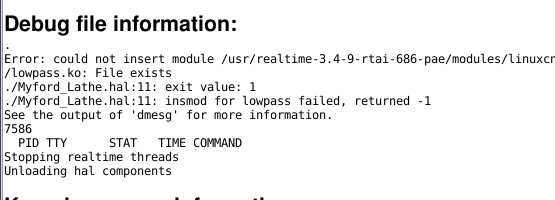

Ok Andy commented out ###loadrt lowpass names=lowpass.spindle.gain

That wasn't the line I was suggesting you comment out. The "Offending line" is given in the error report, line 190 of the file "Myford_Lathe.hal"
Some HAL background.
When you loadrt lowpass you get the pins and parameters listed here:
linuxcnc.org/docs/2.7/html/man/man9/lowpass.9.html
So, typically lowpass.0.gain, lowpass.0.in etc.
If you use names= then the pins get new names. If you use "names = lowpass.spindle.gain" then the pins/parameters are lowpass.spindle.gain.gain and lowpass.spindle.gain.in and so on.
What you need is "loadrt lowpass names=lowpass.spindle"

You have tried to loadrt the lowpass component twice, with two different names
loadrt lowpass names=lowpass.spindlePlease Log in or Create an account to join the conversation.

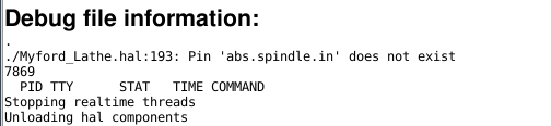

What is the background here? how did you end up with this file which has all the net commands but none of the loadrt commands?
loadrt abs names=abs.spindle

WE (you) are getting there axis now loads with no errors .
The file was generated by PnCConf for my lathe But I know there are bugs in PnCConf some have been sorted but have missed 2.7.4
Now I need to connect up the index A and B from the encoder. I will report back when I have done it
