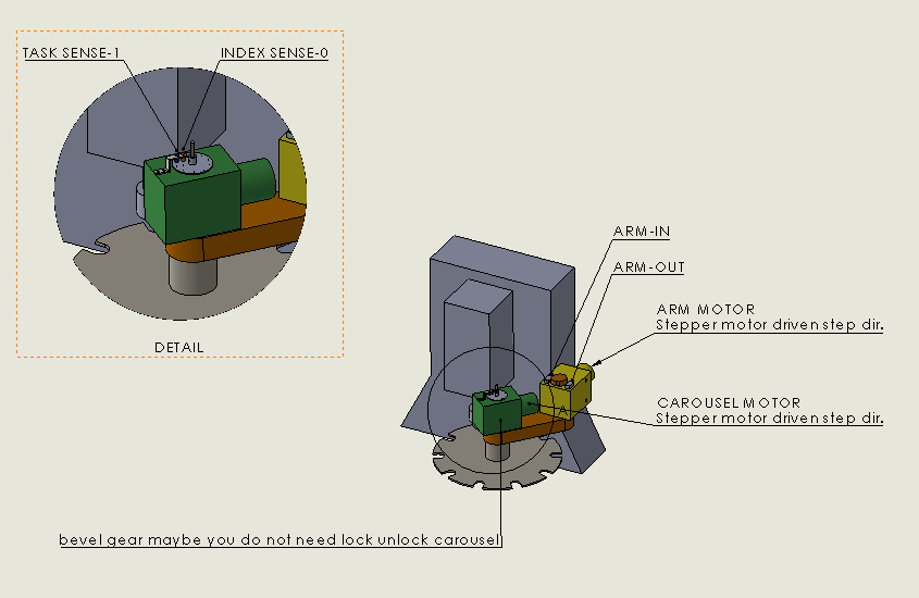

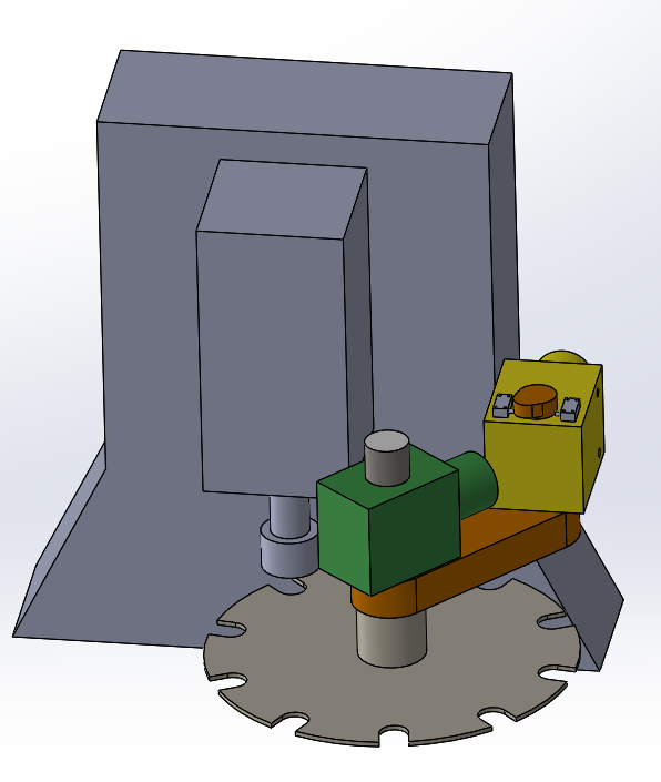

27 Feb 2019 10:33 #127233
by gmarconi2
Replied by gmarconi2 on topic ATC with carousel.comp and M6 remap
Andypugh rereading your previous aid to my post I managed to configure the pin hal of my mesa 7i76, through hal show I see how the pins react to the tool change.
Unfortunately I did not finish now I have to run my ATC.
For the moment, I'm leaving the spindle.
I enclose a drawing of how my ATC is made and how I would mount the sensors.
Thanks in advance for the help
Greetings Gmarconi2

- Posts: 19902
27 Feb 2019 15:51 #127252
Replied by andypugh on topic ATC with carousel.comp and M6 remap
I would suggest using a couple of stepgens in velocity mode to drive the stepper motors.
Use analogue outputs from the G-code to drive the arm in and out (just send a speed straight to the motor, stop when it hits the end-stop, which will need a sensor)
The carousel component outputs velocity for the carousel directly, so that stepgen can be direct-wired (in HAL)
I think that a stepper will probably have enough holding torque to not need a carousel lock.
- Posts: 19902
27 Feb 2019 15:54 #127253
Note that in the above, I am talking about the 2.8 version of carousel. The analogue speed outputs are not present in the 2.7 version. But it is fairly easy to install the 2.8 version in 2.7 with halcompile. (halcompile -install carousel.comp) after downloading the
source file
