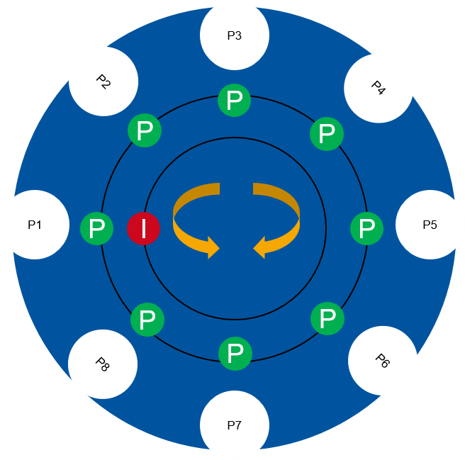

21 Oct 2019 16:18 #148481
by GuiHue
Replied by GuiHue on topic ATC with carousel.comp and M6 remap
Dear all,
I'm sorry for opening an old topic again. I am currently evaluating different options regarding an ATC setup. Rack and carousel are both viable options for me. With Carousel having the added bonus of being available as a comp.
Reading through this thread there is one thing that has me puzzled:
What kind of sensors are used and how are they operated. gmarconi2 has two sensors in use which I assume relate to:
carousel.N.sense-M bit in (M=0..personality):
Carousel position feedback pins. In ’index’ mode there will be only 2 pins. sense-0 is the index and sense-1 is the pocket sensor.
I have drawn up a simple sketch to illustrate my interpretation and would greatly appreciate any feedback as to whether or not this is correct.
I have assumed what follows:
-Sense-0 and sense-1 are both inductive sensor looking for targets on different diameters around the axis of rotation
-Sense-0 is looking for an index ((red target labeled I); 1 target on circumference); = home = Pocket 1 (or 0)
-Sense-1 is looking for a target for each pocket (green targets, labeled P), carousel uses this to know how far it has travelled (hence the use of velocity mode over distance)
@gmarconi2: Have you ever followed up an Andys lead regarding the use of step/dir?
- Posts: 19902
23 Oct 2019 23:28 #148654
Replied by andypugh on topic ATC with carousel.comp and M6 remap
carousel.comp can use a variety of different sensor setups.
For your 8-position carousel I think I would use 4 sensors, 3 x absolute binary coding 0 to 7 and 1 index / strobe.
