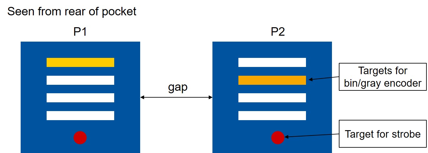

Andy, thank you very much again. I did a bunch of reading this morning and I think I am getting closer to understanding stuff.
I hope to now understand the encoding mode index. I will make a mockup at home (easy enough to do).
As far as encoding=gray is concerned, a few questions remain:
-I understand that carousel takes care of reading the input of the sense pins; no messing about with mux15 or mux_generic required, correct?
-You wrote: "16 tools is 4 sensor + strobe". I understand the 4 sensors are for the pocket itself. When does strobe come into play? Is the strobe used to indicate where exactly the pickup position is (e.g. in the centre of the pocket, whereas the encoding covers a larger band) (see attached drawing)
-Say we do not have a carousel but rather a chain with pockets attached to brackets. At the back of each pocket, there is the encoding stuff for the four sensors (4 stripes in the drawing). As the pockets are mounted to the outside of a chain, they separated from each other. This means that there is no continuous strip for the encoder pins and hence there will be a signal "0" across all pins. Can this be dealt with by carousel? Or would this require dealing with the signal input through a mux and sending in the current pocket number using another encoding mode? If so, which?

30 Oct 2019 13:50 #149169
I think that should be OK, and is one of the reasons to use the "strobe" as it is also used to indicate that the current binary / gray number is valid rather than in an intermediate state.
Sam's K&T has the bar-codes on the tools, it doesn't need to know which pocket each tool is in. But then it doesn't use carousel either.
Replied by andypugh on topic ATC with carousel.comp and M6 remap
Yes, exactly that. It isn't 100% necessary on some machines (for example those with a Geneva motion)-You wrote: "16 tools is 4 sensor + strobe". I understand the 4 sensors are for the pocket itself. When does strobe come into play? Is the strobe used to indicate where exactly the pickup position is (e.g. in the centre of the pocket, whereas the encoding covers a larger band) (see attached drawing)

Faster than lightning! Thank you so much.
Now onto planning how to actually build stuff. I was mostly set on a rack style, but I’ll guess I will reconsider another design in the long run. Can’t wait to give this a try.
