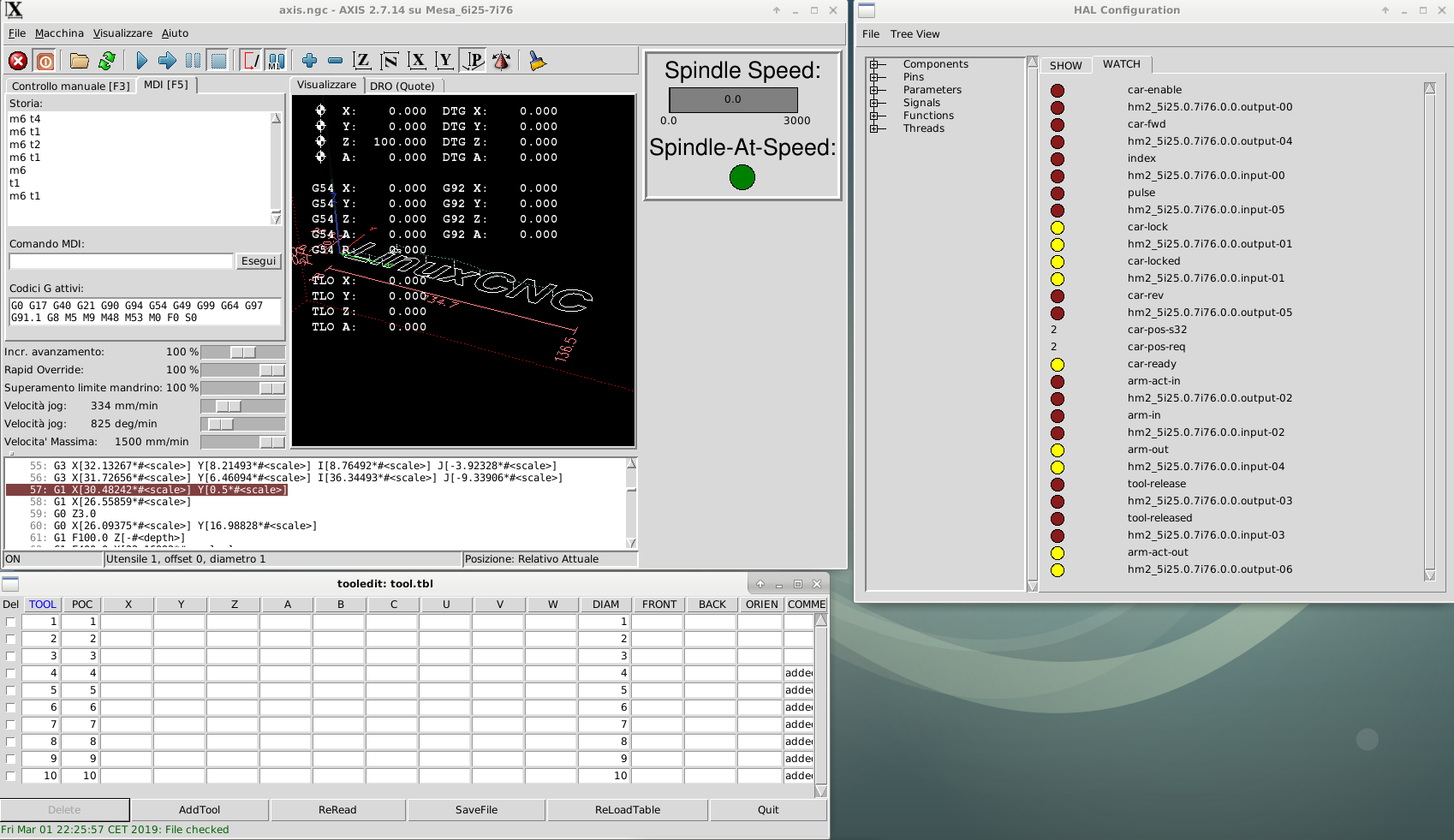

01 Mar 2019 21:33 #127462
by gmarconi2
Replied by gmarconi2 on topic ATC with carousel.comp and M6 remap

02 Mar 2019 19:52 - 02 Mar 2019 19:54 #127538
by gmarconi2
I added in the .ini file the parameter from:
RANDOM_TOOLCHANGER = 0
and now it seems to work
Greetings gmarconi2
Greetings gmarconi2
Last edit: 02 Mar 2019 19:54 by gmarconi2.

02 Mar 2019 20:46 #127544
by gmarconi2
Ok andypugh because it works with RANDOM_TOOLCHANGER = 0
and it does not work with RANDOM_TOOLCHANGER = 1
greetings gmarconi2
greetings gmarconi2
