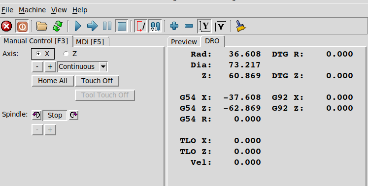

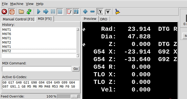

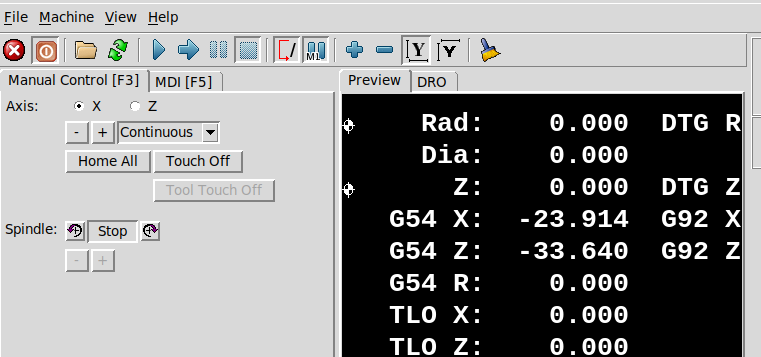

21 Nov 2020 09:02 - 21 Nov 2020 11:00 #189976 by Clive S
Replied by Clive S on topic How to make a tool changer move to home
Seems to me you would need to add this to your INI
REMAP=M6 modalgroup=6 ngc=mychange
Then create a file in your remap folder called mychange.ngc and put this inside:
o<mychange> sub
G53 G0 X0
M66E0L0
G0 Z0
M6 (use built in M6 behavior)
o<mychange> endsub
m2
Z & X farthest from chuck
First home machine screenshot
Then MDI m6t2 (You have to inform the gui what tool is in the slot so it knows the tool pocket number)
X went up +ve (ignored soft limit) and Z went towards chuck so aborted
Aborted Screen shot
Restarted lcnc
Re-homed then moved x and z nearer the chuck and touched off
touch off screenshot
Then MDI m6t2 X went up and hit the switch
Screenshot
Sorry I could not find a way to rotate. Well I did rotate but it still made it upside down
So getting there slowly Thanks for the previous help
