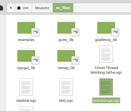

Ok Thanks for the above. I think I am missing something where is the actual remap folder that the sub should live.
Presuming the entry now looks like this:
[RS274NGC]
SUBROUTINE_PATH = ./remap_subs
My ini:
[RS274NGC]
PARAMETER_FILE = linuxcnc.var
REMAP=M6 modalgroup=6 ngc=toolchange
This is where I have put the sub. toolchange.ngc . Is this correct, It works like this

22 Nov 2020 12:33 - 22 Nov 2020 12:35 #190070 by Aciera
Replied by Aciera on topic How to make a tool changer move to home
Ok, so we both learn as we go:
The file myprocedure.ngc is expected to exists in the [DISPLAY]NC_FILES or [RS274NGC]SUBROUTINE_PATH directory.
So you could also add the path in the [DISPLAY] section.
although really for orders sake you should maybe create that "remap" folder.

22 Nov 2020 13:04 #190074 by Aciera
I think you should:
-go to your config folder
-create a folder called remap_subs and move your toolchange.ngc into it (so: ./config/remap_subs/toolchange.ngc)
-create an entry in the [RS274NGC] section of your INI: SUBROUTINE_PATH = ./remap_subs
That is how I have it but there is really no right or wrong.
22 Nov 2020 13:08 #190075 by Aciera
I think you should:
[edit]
your present setup works because you have your toolchange.ngc in your NC_FILES folder and that is defined in the [DISPLAY] section in your INI. And apparently that folder is also checked for subroutine files.
