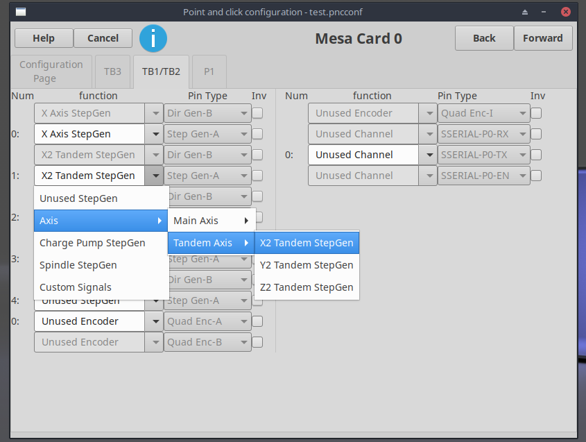

i have used the 7i96 Config Tool and did get a machine running while connect to the board but not to stepper just yet. also i can movement on xy and z but not the forth axis. I have a gantry machine XXYZ and i have searched high and low for examples of this configuration but nothing comes close to the ini or hal files that are generated by the tool. I see in the example that the gantry is yy or xx but not xu or yu as i would expect. Yet if i try to remove a reference to the u axis linuxcnc fails. Attached are my ini and hal files.

Replied by RNJFAB on topic 7i96 configuration Tool and Gantry XYZ Machines
Hey SSIRon,
I'm no expert, they will be around shortly.
I found when I set up my machine it created a y & y1 axis for the gantry. these were then linked in the ini file.
I have attached a example of it below. This was all created when setting up the machine in the config. I made sure I put a sticker on each axis motor so I knew when adjusting limits which motor I was adjusting. Its amazing how quickly you can get lost in the CNC maze.
I would re-do the config and set up your machine with a y & y1 or a x & x1.

OK i reconfigured this as xxyz / joints 0123 with two x axis and i get an error when i try to run linuxcnc.
here are my ini , hal and debug report

ok i am using the 7i96 config tool it is different than what you are showing there. I tried to manually change the ini. adding x1 in two locations. LInuxcnc ran but it disconnected from the animation when i jog the axis and it renamed them joints 0123 instead of axis xyz

Replied by tommylight on topic 7i96 configuration Tool and Gantry XYZ Machines
Delete the whole X1 section.
The rest looks ok.

03 Jan 2022 04:14 #230620
by SSIRon
Replied by SSIRon on topic 7i96 configuration Tool and Gantry XYZ Machines
OK i did the deletions and i still have the disconnection from the animation and the joint 0123 instead of axis xyz
