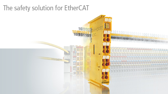

Hi Tom,
What would you do ?
In my case i would replace all current plc's with a Ethercat bus sytem with integrated safety bus in the same flow to
get the Ce stamp.
The ethercat cable then coupled to one linux pc with a custom lcnc interface (with 64 bit ethercat) to stuer and visualize the process.
Lcnc hal will become the production line brain. Maybe a few custom components are handy. And you can service the system by internet.
If you need any help, no problem.
Like this :
You may not trust your work on old plc's. If they work for a few weeks, the line may stop working.
In this case, you can sell a high end solution to your customer.

In this case it would cost over 100K just in parts to replace.
Leme go back and add some more info up there that i forgot.

The trouble is that now the seller has banked the money the risk is he won't bother to help. I knew a guy who bought a tallow rendering plant once and the seller promised the earth and then did nothing. It sent the guy broke!
The other thing is that you must tell your customer there is a risk you can't complete the task but that you need to be paid your hourly rate for the time you put in. Be sure to invoice weekly and that terms are strictly 7 days. If you are not paid by the end of the second week, work stops.
And yes, Grotius's idea of using ethercat with or without Linuxcnc might actually make sense even if it takes you out of your comfort zone!
