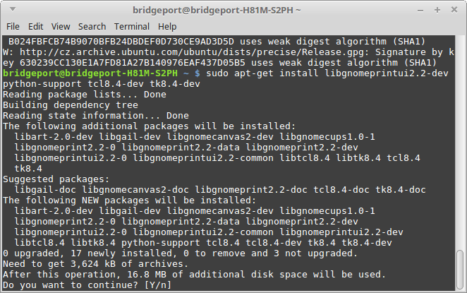

08 Apr 2017 08:14 - 08 Apr 2017 08:15 #91043 by cncnoob1979
Elroy try this command and report what happens please.
sudo apt-get install python-support
Last edit: 08 Apr 2017 08:15 by cncnoob1979.
  • cncnoob1979
  • cncnoob1979's Avatar Topic Author
  • Offline
  • Platinum Member
  • Platinum Member

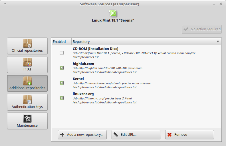

08 Apr 2017 08:44 - 08 Apr 2017 09:03 #91045 by cncnoob1979
I just checked to make sure your dependencies are in this repository; this will get you going. Let me know how it goes.
sudo add-apt-repository 'deb http://mirrors.kernel.org/ubuntu precise main universe'
sudo apt-get update
sudo apt-get install libgnomeprintui2.2-dev python-support tcl8.4-dev tk8.4-dev

So I added this to each posting including the main post... The information was there but I made it bullet proof.. I think!
Commonly reported dependency:
dpkg-checkbuilddeps: error: Unmet build dependencies: libgnomeprintui2.2-dev python-support tcl8.4-dev tk8.4-dev
To fix the issue above please issue this code:
sudo apt-get update
Regards,
James
