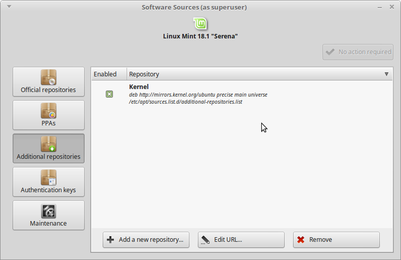

6) Post the image file of your sources listed in synaptic package manager. You have multiple entries listed in there; should only have one "deb linuxcnc.org/ precise base 2.7-rtai"

Now remove the additional repository you have there. *delete it* (Kernel listing)
