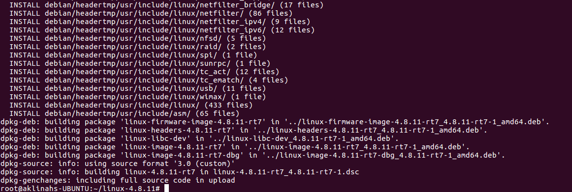

04 May 2018 08:00 - 04 May 2018 08:02 #110198
by Aklinahs
Replied by Aklinahs on topic Complete HOW-TO Linux Mint 18.1 32/64 PREEMPT with RIP or build a .deb
I Have done earlier steps successfully .
and finally I got this...
What I have to do next ??
Can you please tell me this by step by step...
//One executed **after the xconfig step** it will auto configure and compile - also sending this to the packager to create a deb file for you to install. Very easy! The benefits are being able to remove and reinstall the package easy. The down side is -- it does take awhile.
You will have multiple files created in your home folder. The files will be in your root home folder named linux-headers-4.9.4-rt2_4.9.4-rt2-2_i386.deb ; linux-image-4.9.4-rt2_4.9.4-rt2-2_i386.deb, modules and a multitude of others. You can tell via the size and naming scheme which to install. In my case I wanted to install the kernel headers, modules and also the actual kernel. My kernel package [.deb] was approximately 45MB.
To install the deb just click on the individual files and the package installer will open. Click install package and enter your su password. Do this for the headers, modules and the linux-image deb's.
After completing the build / install it will update the boot loader for your new kernel. (takes about 45 min for me)
NOTE: After a reboot you can select which kernel using the grub menu you see prior to loading Mint.
NOTE: Under the advance options for … ect
I like to use grub-customizer to make my selection of kernel persistent.

- cncnoob1979
- Posts: 403
- Thank you received: 75
04 May 2018 08:32 #110199
by cncnoob1979
Replied by cncnoob1979 on topic Complete HOW-TO Linux Mint 18.1 32/64 PREEMPT with RIP or build a .deb
You are building the kernel at this stage.
You have to install the;
-kernel headers, modules and also the actual kernel, The naming scheme should give you a clue.
-You have to tell Linux grub what kernel you want to boot from after a reboot.
-This is either completed by using an application or advance options during a Linux reboot.
I list the methods in the how-to
-after that's complete execute [after a reboot and selecting the recently built kernel]
and it should list what kernel you are running, if it states anything with a -generic in it, then that is the factory kernel.
This step is not LinuxCNC specific. If you need further help I would recommend you watching a YouTube video on how to compile and install a Linux kernel. Further in the posting I listed a video I recommend that can help you.
uname -aand it should list what kernel you are running, if it states anything with a -generic in it, then that is the factory kernel.

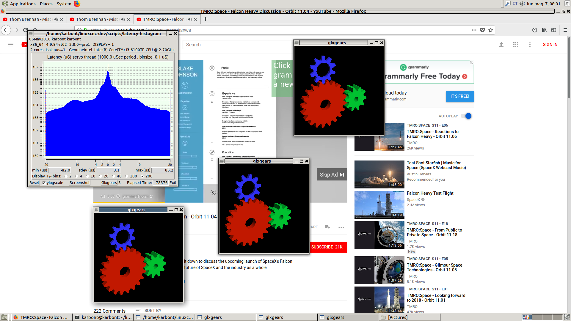

07 May 2018 01:09 - 07 May 2018 01:11 #110311
by bkt
here my latency after 24h of histogram wit ubuntu mate 16.04.04 rt-62 v. 4.9.84 isolcpu and hyperthreading diabled, all intel cpu control feature disabled (disabled virtualization), all cpu power control disabled, sudo apt-get purge --auto-remove irqbalance, using script of these link forum.linuxcnc.org/18-computer/25927-red...lticore-pc-s-success by Nebur.
Note: 3 youtube video run for 24h ever, 3 glxgear run for 24h ever. Probabily with a most fine bios and rt-config tuning (in rt config I change only fully rt-preempt flags and no other) the latency go down ... but for mesa servo machines is quite good result.
regards
Giorgio
Replied by bkt on topic Complete HOW-TO Linux Mint 18.1 32/64 PREEMPT with RIP or build a .deb
regards
Giorgio
