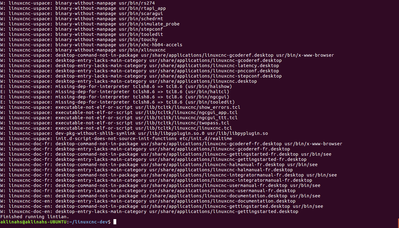

'm trying to install linux cnc to ubuntu 16.04 64bit...
now im at this step
sudo apt-get update
cd linuxcnc-dev
cd debian
./configure uspace [ or ./configure -r]
cd ..
dpkg-checkbuilddeps
when i entering this line ./configure uspace im getting an error saying
unknown distribution: Ubuntu-16.04
configuration may be wrong!
successfully configured for 'uspace-Ubuntu-16.04'-'uspace'..
What could be the error
now im at this step
sudo apt-get update
cd linuxcnc-dev
cd debian
cd ..
dpkg-checkbuilddeps

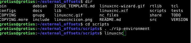

Hi K1,
Nice avatar !! Pinquin kenobi...
For run linux in place, the exact typing command is very strange indeed, for me in beginning also very confusing :
. ./rip-environment ( dot space dot / rip-environment )
linuxcnc
Sector 1:
in code :
In picture :
I see Aklinahs is installing lintian.... There is no ask for " sudo make setuid " ... So that is different from orginal linuxcnc install.
No experience for me so far with lintian.
I would prefer first command after compiling would be : sudo make setuid
After that change to scrips directory and type sector 1.
linuxcnc
Sector 1:
in code :
. ./rip-environment
linuxcncIn picture :
