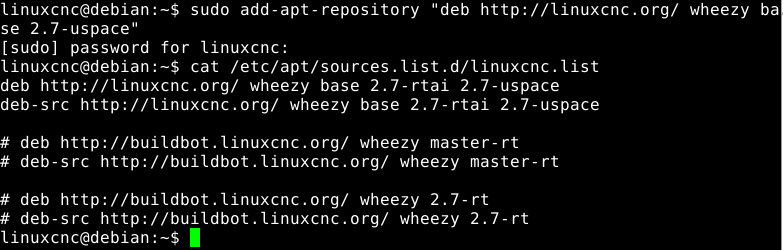

Replied by ozzyrob on topic Complete HOW-TO Linux Mint 18.1 32/64 RTAI or PREEMPT with RIP install or deb
Installing uspace will also install the kernel no need to build one.
if not try:
Do you have a
Mine is as such, if you edit yours to match make sure to do
Just checked and seems to be working.
if not try:
sudo apt-get --install-recommends linuxcnc-uspaceDo you have a
/etc/apt/sources.list.d/linuxcnc.listMine is as such, if you edit yours to match make sure to do
sudo apt-get updatedeb http://linuxcnc.org/ wheezy base 2.7-rtai
deb-src http://linuxcnc.org/ wheezy base 2.7-rtai
deb http://linuxcnc.org/ wheezy 2.7-uspace
deb-src http://linuxcnc.org/ wheezy 2.7-uspace
#deb http://buildbot.linuxcnc.org/ wheezy master-rt
#deb-src http://buildbot.linuxcnc.org/ wheezy master-rt
#deb http://buildbot.linuxcnc.org/ wheezy 2.7-rt
#deb-src http://buildbot.linuxcnc.org/ wheezy 2.7-rtJust checked and seems to be working.
Last edit: 03 Jun 2018 15:40 by ozzyrob.

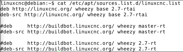

03 Jun 2018 16:02 #111556
by Sparky961
Replied by Sparky961 on topic Complete HOW-TO Linux Mint 18.1 32/64 RTAI or PREEMPT with RIP install or deb
So in the meantime, as I'm working and posting at the same time, I did install the preempt-rt kernel and everything seems to be working with that. Maybe I'll have to uninstall that later, and I hope it's as easy as installing - because that was truly painless.
My /etc/apt/sources.list.d/linuxcnc.list does not match what you provided. I have not manually altered it from the initial install, so I see two possibilities: 1. you or some other application has added the -uspace lines to yours 2. some other application has removed the -uspace lines from mine.
So now I have to decide which of the two instruction sets to keep following....
(Aside: Sorry if this is to be considered "thread hijacking". It started out related but has taken a different direction than I anticipated. Feel free to tell me to take it elsewhere.)
On a related note, the dist-upgrade for my Mint install is STILL running. I'm not far off from 24 hours of run time on that now. It has until tomorrow morning to finish, then I'll have to restart it at work. On the plus side, my work network is blazing fast in comparison to home.

03 Jun 2018 16:14 #111559
by Sparky961
No need to apologize. If I'm not used to conflicting and incomplete information by now I really shouldn't be doing this.
I wonder if step #8 in the "Getting LinuxCNC" article will alter that file in the same way. It seems it's doing the same thing. I'll check if this file is altered after I'm done.
linuxcnc.org/docs/html/getting-started/g...th_preempt_rt_kernel
