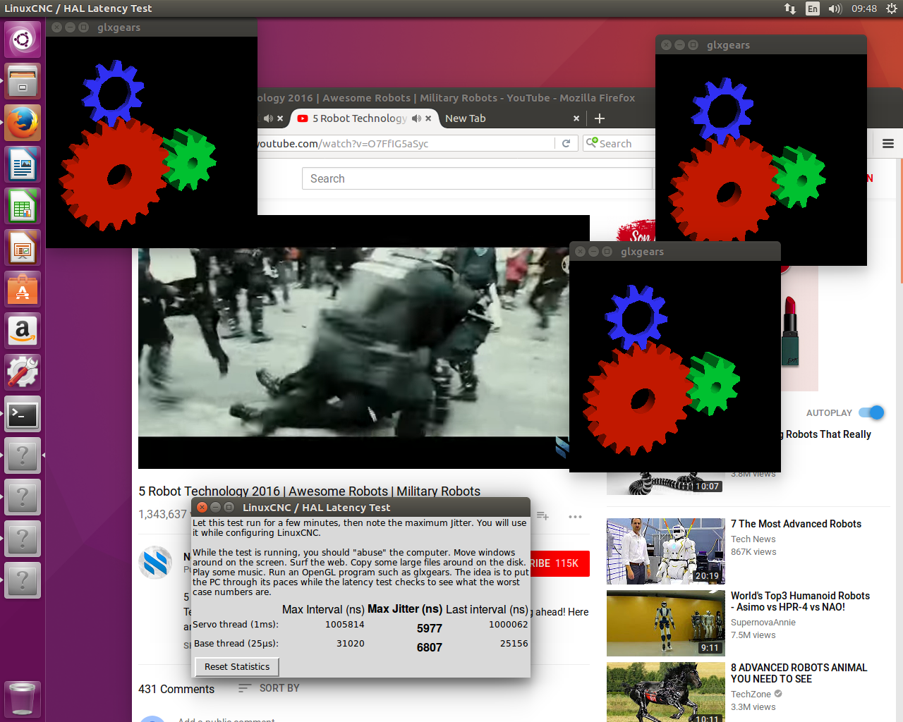

building linuxcnc-dev on ubuntu 16.04 preempt-rt kernel was created by thang
This tutorial about how to install linuxcnc-dev on ubuntu 16.04 and preempt-rt kernel. It includes 3 steps:
step1: install preempt-rt kernel
step2: install linuxcnc-dev
step3: fix latency

Step 3: reduce latency
+ after you installed linuxcnc-dev, it's time to do first test with latency-test
+ if your latency spike up to 100-300ums or more after some seconds so i think u need fix smi. You can follow this link to fix it by rtai_smi.ko: wiki.linuxcnc.org/cgi-bin/wiki.pl?FixingSMIIssues . If it doesn't work, let try fix it by smictl that is described at the end of page. Here is detail how to fix smi by smictl:

+ Now let try run latency-test again and hope it works
+ If your latency test still high a bit and you are using a CPU multicores then u can reduce latency by disable multicore very simple by:
sudo nano /etc/default/grub
add line GRUB_CMDLINE_LINUX_DEFAULT="isolcpus = 1" if you have duo core ( there are somethings else in " " just dont remove them), isolcpus = 1,2,3 if you have quad core cpu (1,2,3 mean core1,core2 and core3, cant disable core0)
sudo update-grub
reboot
Here is my result:

- Posts: 19904
03 Nov 2017 12:23 #101280
Replied by andypugh on topic building linuxcnc-dev on ubuntu 16.04 preempt-rt kernel
Latency is excellent, no need to do any further tuning.
