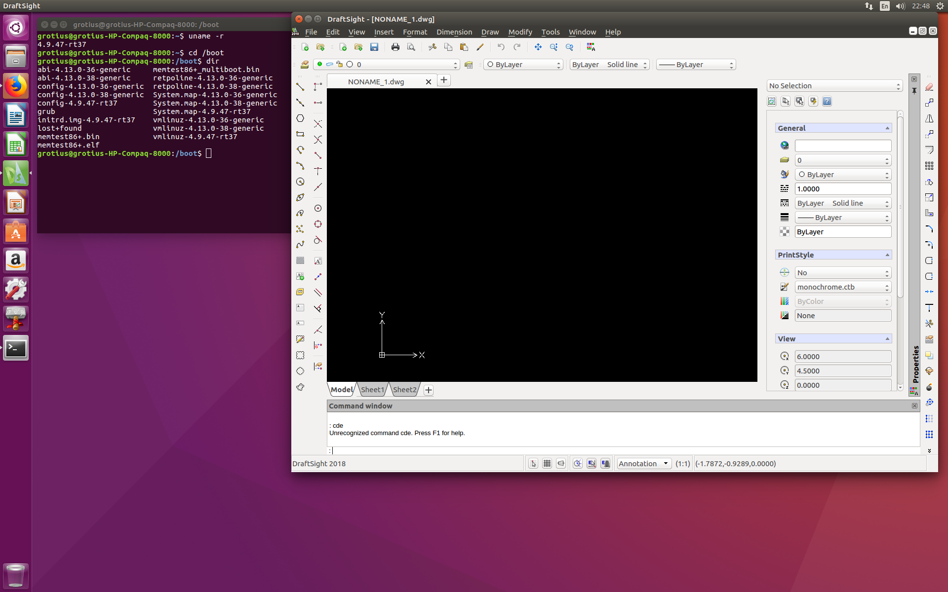

- Grotius
- Posts: 2419
- Thank you received: 2349
12 Apr 2018 15:58 - 12 Apr 2018 16:09 #108901
by Grotius
Replied by Grotius on topic building linuxcnc-dev on ubuntu 16.04 preempt-rt kernel
Hi i get the kernel also working with draftsight 64 bit.
In the menuconfig i see this :
kernel hacking menu : IO delay type (no port-IO delay)
I choose no delay, standard is with delay, somebody advise?
I had error to solve :
Error : the frame size of 1056 bytes is larger than 1024 bytes
Solved with : menuconfig => Kernel Hacking Menu => changing frame size from 1024 to 2500
Boot directory no space available anymore.
Solved with : deleting old files with command : sudo rm filename
I used the tutorial kernel links :
wget mirrors.edge.kernel.org/pub/linux/kernel.../linux-4.9.47.tar.gz
wget mirrors.edge.kernel.org/pub/linux/kernel...4.9.47-rt37.patch.gz
If i want to install the latest kernel file combination.. Is it better to do this, or leave it like this?
Many thanks for this nice tutorial.
