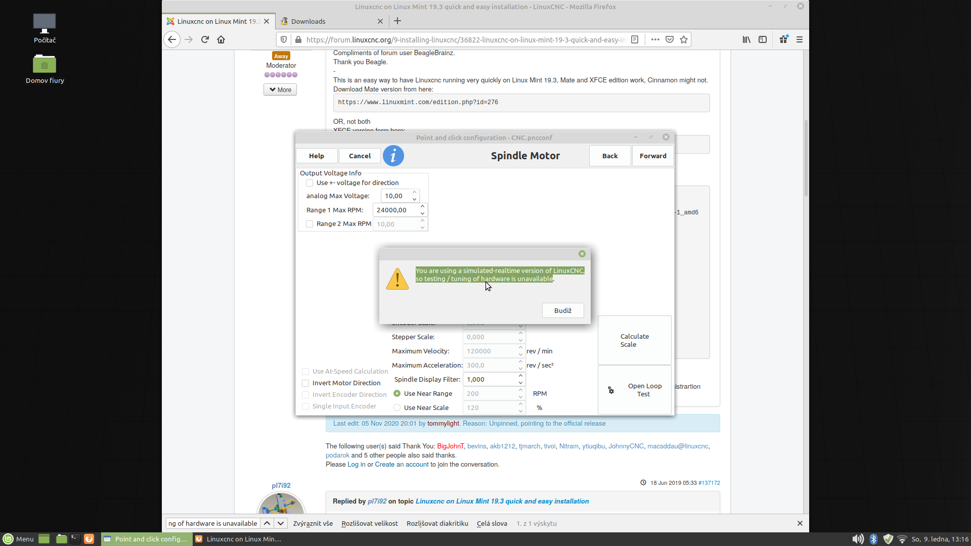

09 Jan 2021 06:44 - 09 Jan 2021 06:45 #194586
by Fiury
Replied by Fiury on topic (superseeded) Linuxcnc on Linux Mint 19.3 quick and easy installation
Hello,
i intalled Mint 19.3 and linuxcnc , but i cannt run VDF via terminal:
a) PC - intell NUC
b) board - mesa7i76ed
i have warning in setup of mesa (by spindle): You are using a simulated-realtime version of LinuxCNC, so testing / tuning of hardware is unavailable.
Have i problem with system or VDF setup ? (is the warning ok ? probably not i think so..)
Thank you for support
a) PC - intell NUC
Last edit: 09 Jan 2021 06:45 by Fiury.
- Posts: 22030
- Thank you received: 7504
09 Jan 2021 06:54 #194587
Replied by tommylight on topic (superseeded) Linuxcnc on Linux Mint 19.3 quick and easy installation
Ahoj Jane,
On the first page of pncconf untick the "create simulated......"
And start a new topic for the VFD issues, this is for installation issues only.
