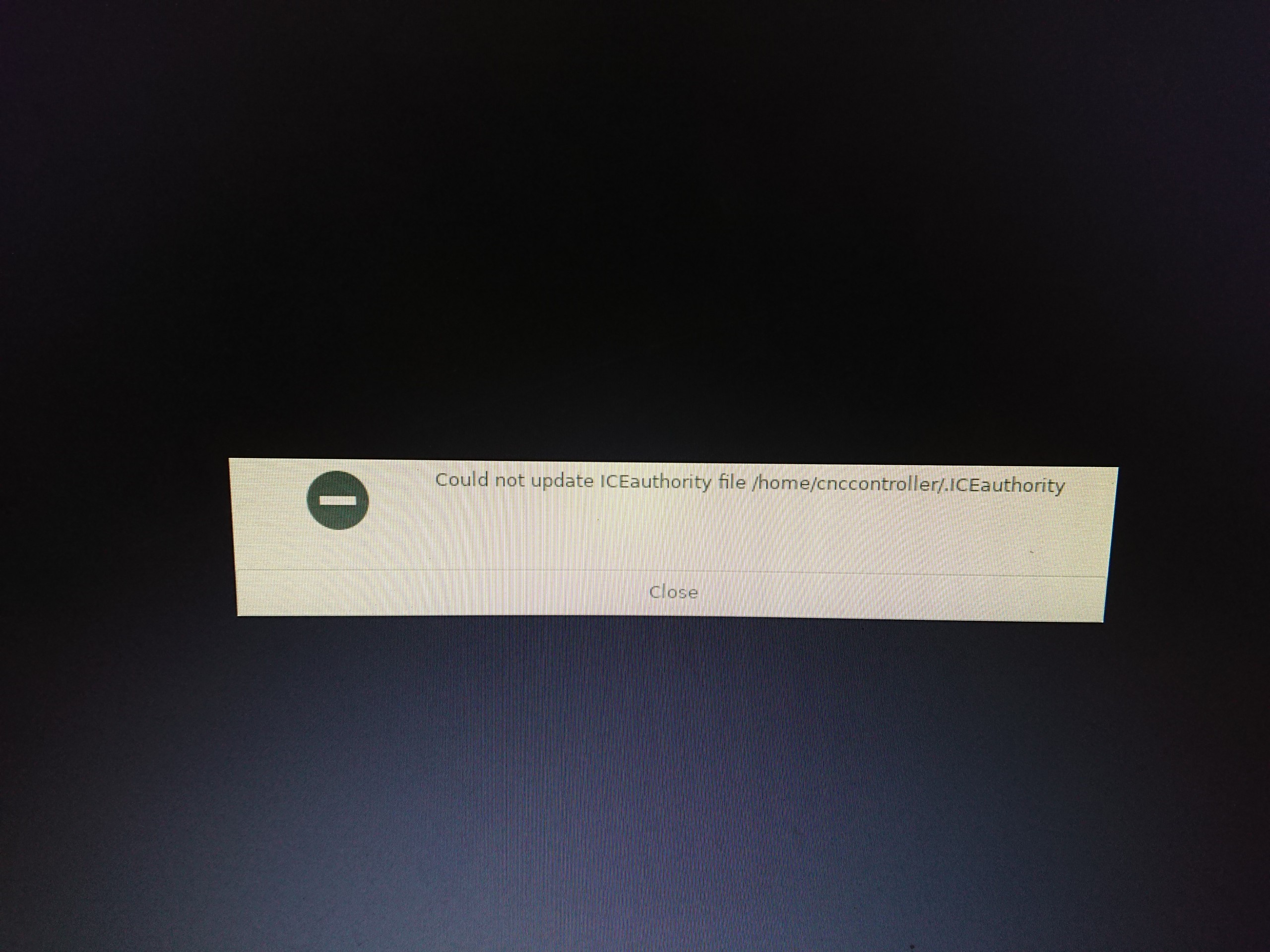

27 Feb 2020 04:35 - 27 Feb 2020 04:41 #158616 by tivoi
Replied by tivoi on topic Custom Mint-19.2 with Linuxcnc
i'm sorry
now i have prolem with linuxmint, it can boot in to os,
i need press some button like alt+ number or word
and this is boot mess after turn off computer without shutdown
b.r

27 Feb 2020 05:45 #158618 by BeagleBrainz
Replied by BeagleBrainz on topic Custom Mint-19.2 with Linuxcnc
CTR ALT F1 will get you a terminal
The issue is that you do not have permissions to write to the files, the permissions need changing.
All the times I have installed mint I have never had this problem occur, sometimes it does. Causes can be when installing you choose login without password or encrypt home directory.
login with your username & password
sudo chown -R cnccontroller /home/cnccontroller
sudo reboot
If the above instructions fail you can try reinstalling but do not select login without password nor encrypt home directory.
