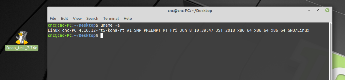

Ok. I have downloaded the latest ISO then made the boot stick. Booted fine and installed fine but on reboot of the SSD I also got the message as above I think then I press shift and return and waited it eventually booted.
But I did set the option to login without psw so that is probably the problem. I will try again without using that option
logged out then and restarted no problems. Restarted several time without any problem.
I will report back after total reload from stick.
Edit: I did not use the add third party stuff when installing

I assumed, from your screenshot, that cnccontroller was your user name.
usr is a very poor choice for a Linux username.
If you did not create a user with the username cnccontroller where is this coming from ?
It does not seem right that the installer created a user with that name.
When you installed did you format the partition you were installing to ?
What user name did you use to login into the console terminal with ?
What was the exact error you got, simply saying error’d out does not give any information at all and makes it impossible to know what the issue is and fix it?
Is your home partition on the same partition as / ?
Or is your /home mounted as a separate partition ?
What is the output of of
ls -la /home
There appears to be something very wrong with the installation.
Sorry for any confusion. I don't see cnccontroller in the screenshot. My usr name is cnc and psw is cnc ie both are cnc
I generally use this when setting a machine up then put a stronger psw in later.
I am going through the install again without setting the login to auto. As it is easy to do once it is all installed
If you want me to stop posting on this I will not be offended. :)
Edit: Everything went to plan. Thanks for all the work you have put in.
