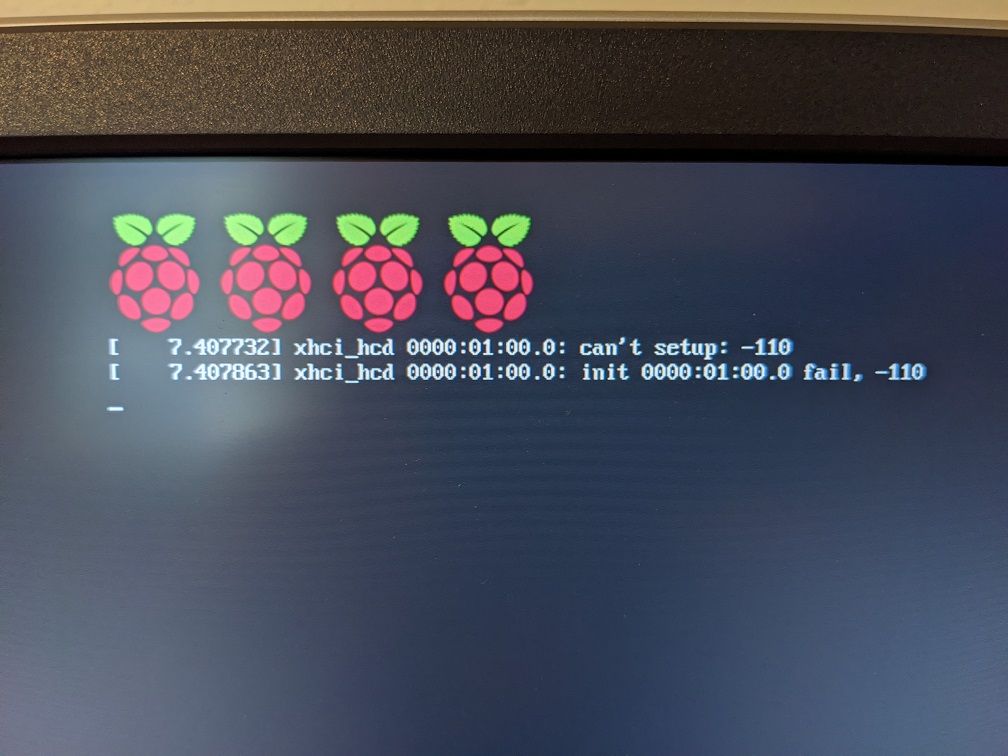

So i downloaded [2020-08-20-raspios-buster-armhf.img] and followed the instructions [gnipsel.com/linuxcnc/uspace/rpi4-rt.html] to install PREEMPT RT, no issues in compiling and installing, at reboot i got the errors
xhci_hcd 0000:01:00.0: can't setup: -110
xhci_hcd 0000:01:00.0: init 0000:01:00.0 fail, -110
And the machine fails to boot any further, intermittetent green flashing light. So looks like an issue with the RT kernel. This is likely because using external USB SSD.

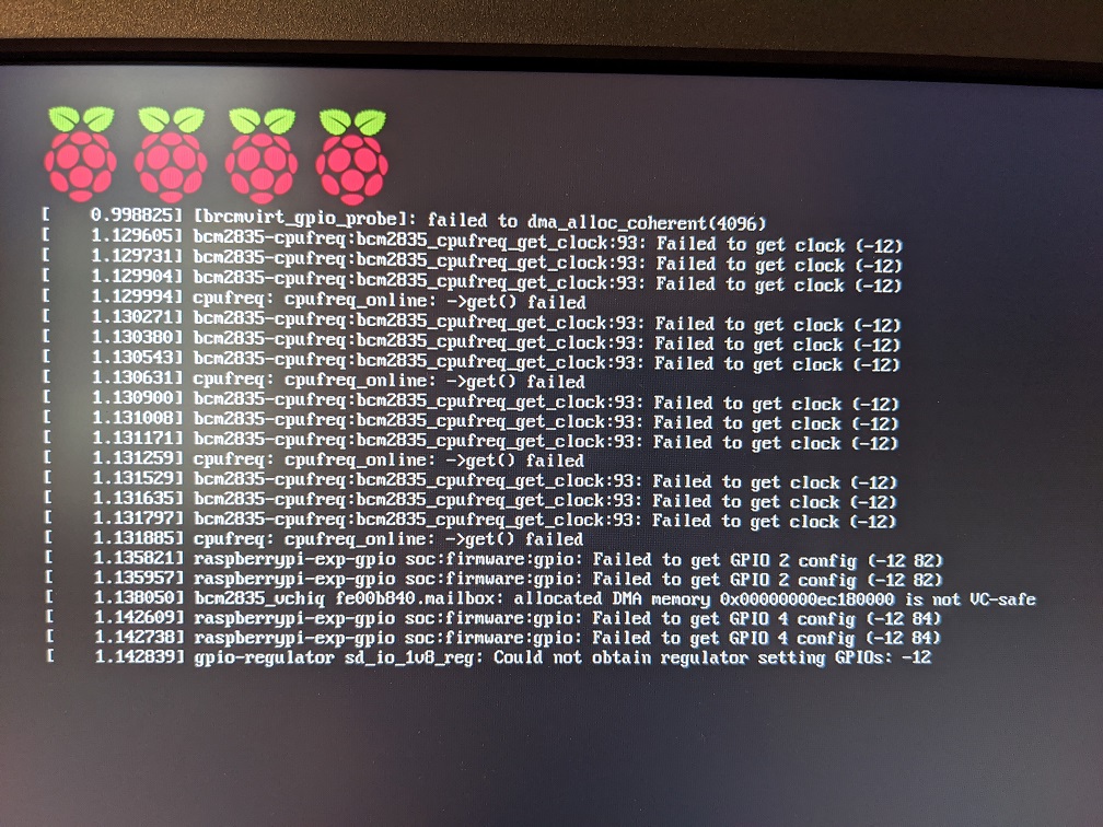

I also tried the pre-made iso [unofficialpi.org/Distros/RealtimePi/nightly/] which gave a whole load of other errors and failed to boot any further.

I made a new kernel image for the newer Pi4. The kernel on the LinuxCNC repository is now that fixed kernel.
It nearly works for the Pi400 too (except no Wifi on the Pi400)
Folllow the instructions here to get a working LinuxCNC on top of a stock Buster install:
linuxcnc.org/docs/2.8/html/getting-start...lling_on_raspbian_10
That process works, I did it myself half an hour ago as part of my testing.
I am working on a new SD card image, but so far have only managed to make a version with no USB on _anything_ so that isn't ready yet.
