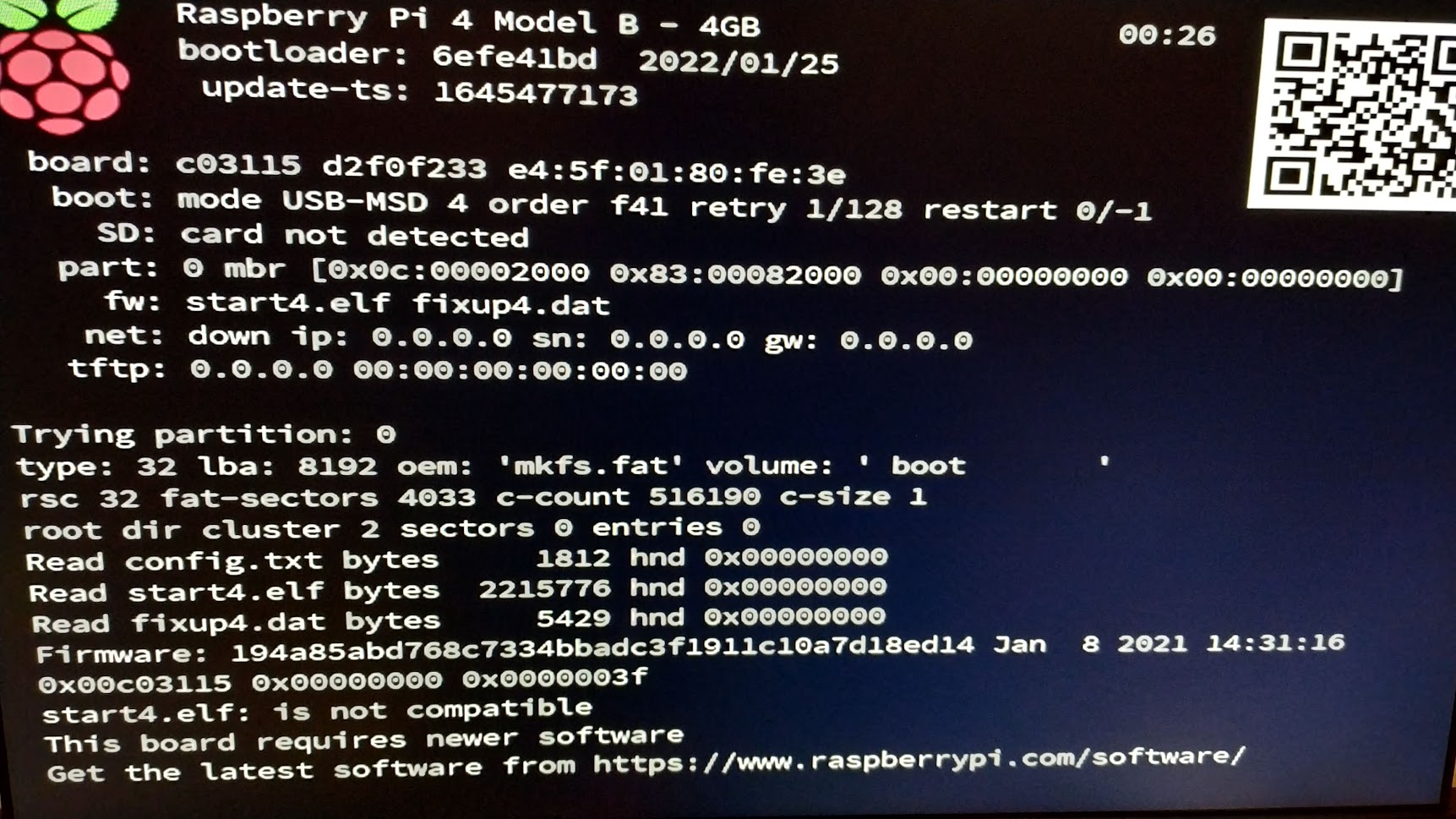

Using the following download:
Any workaround for that one, apart from setting up Raspbian/Debian from scratch?
- LinuxCNC 2.8.1 Raspberry Pi OS based on Debian 10 Buster

28 Feb 2022 07:59 - 28 Feb 2022 08:08 #235994
by elovalvo
You can try it this way:
1) download and install the legacy version of RaspiOS
downloads.raspberrypi.org/raspios_oldsta...ios-buster-armhf.zip
2) apply the procedure to install the kernel PREEMPT_RT (32 bit)
github.com/kdoren/linux/releases/tag/rpi_5.10.74-rt54
3) using the gdebi utility install Linuxcnc 2.8.2 from .deb-packages available
buildbot.linuxcnc.org/dists/buster/2.8-r...g68f883b96_armhf.deb
Replied by elovalvo on topic LinuxCNC on Raspberry Pi 4
[*]LinuxCNC 2.8.1 Raspberry Pi OS based on Debian 10 Buster
I flashed an SD card and put it into my Raspberry Pi 4. It doesn't boot, instead showing the following error: "This board requires newer software". (Screenshot attached)

Hi All,
I also faced with this when iam using "LinuxCNC 2.8.1 Raspberry Pi OS based on Debian 10 Buster", but on 4GB version of RPI4.
I tried with two different SD car, with one USB flash drive, and with external SSD, but same result unfortunatelly.
Apart from everything, somebody have any clue what the problem?
Following elovalvo:
1. I tried to install a PREEMPT_RT kernel, but i am stuck with that.
2. Buildbot: When i want to reach this page, i recieved this message: "this site can’t be reached"
How should i proceed?
Thank you in advance!

- Posts: 19899
15 Mar 2022 00:13 - 15 Mar 2022 00:14 #237269
Replied by andypugh on topic LinuxCNC on Raspberry Pi 4
It's a bit late here now, but I would suggest starting with a standard 64-bit Raspbian install then searching for a packaged RT kernel.
I think it will probably be this one: packages.debian.org/buster/linux-image-rt-arm64
If you find one then the next step is to install is (sudo apt-get installl linux-image....... ) then compile LinuxCNC from source. (As the buildbot is only making 32-bit arm-hf images)
sudo apt-cache search linux-image*I think it will probably be this one: packages.debian.org/buster/linux-image-rt-arm64

15 Mar 2022 08:02 - 15 Mar 2022 08:03 #237299
by elovalvo
From the photo you uploaded it seems that there is a problem at startup because the SD is not recognized and tries to boot from USB.
My suggestion is to download the full image (Raspbian Buster 64 + LinuxCNC 2.8.2) from this link
drive.google.com/file/d/1sdFvmJx439lZQsq...jQE/view?usp=sharing
and use the Raspberry Pi Imager
www.raspberrypi.com/software/
to write to an SD, avoiding booting from external USB.
