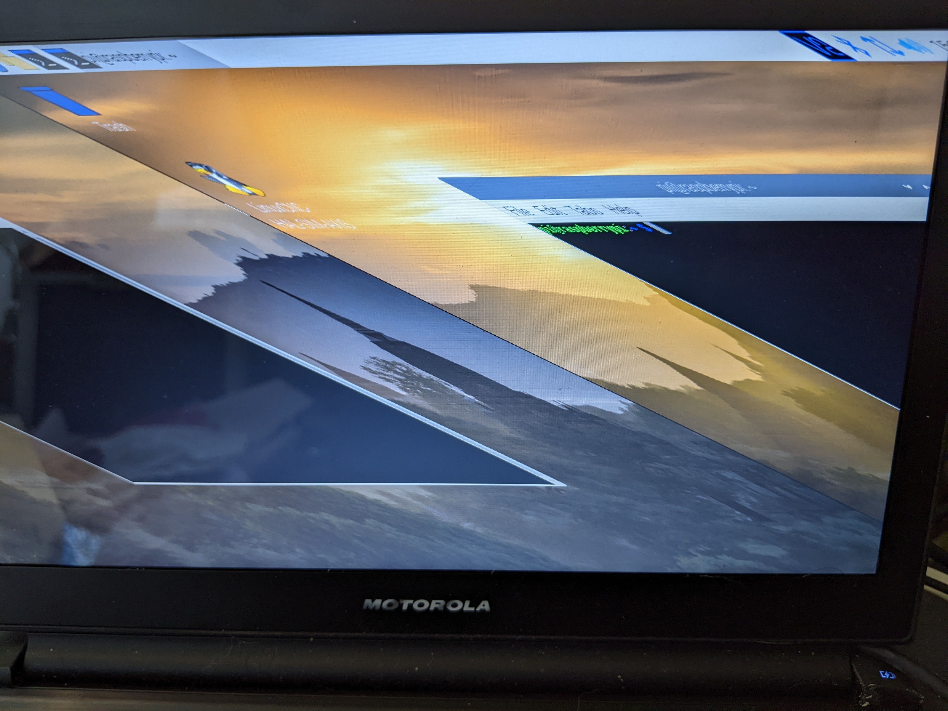

- dannym
- Posts: 220
14 Jan 2023 07:49 #261905
by dannym
Replied by dannym on topic LinuxCNC on Raspberry Pi 4
OK I'm seeing the problem with the "64bit version based on Bullseye with LinuxCNC 2.9.0pre" screen going "no signal" was not what I thought.
That, and this linuxcnc_2.8.4_buster_arm64_rt.zip, on another monitor shows up, but the sync is all wrong, the screen is diagonally skewed.
So neither of these monitors like the RPI4 HDMI in whatever video mode it tries to switch to.
Is there a way to remedy other than randomly buying monitors until one works?
- elovalvo
- Posts: 205
- Thank you received: 127
14 Jan 2023 08:21 #261908
by elovalvo
Replied by elovalvo on topic LinuxCNC on Raspberry Pi 4
I would suggest you check the operation of the HDMI cable in addition to the monitor.
Try using a cable that is not very long.
Instead, to quickly check the operation of LinuxCNC using another computer, there are at least 2 ways.
The first is to use a remote desktop like VNCViewer
(www.realvnc.com/en/connect/download/viewer/)
The other is to use an SSH terminal emulator with X-Windows like MobaXterm
(mobaxterm.mobatek.net/)
In any case, using the raspi-config terminal command you can select the most appropriate resolution for your monitors.

- dannym
- Posts: 220
16 Jan 2023 05:42 #262098
by dannym
I VNC'ed in and tried to change the graphics settings, but all I can see are overscan, pixel doubling, and screen blanking. None of them changed the monitor output.
The cheap Wal-Mart "onn" monitor displays the other RPi 4 stuff fine. Just "no signal" on this image once it's passed the splash screen.
I have this old Motorola dock I've always used with RPis. This time it has an image, but it's still this, weirdly horizontal slant. It's not scrolling around or anything. overscan, pixel doubling, and screen blanking didn't fix anything.
