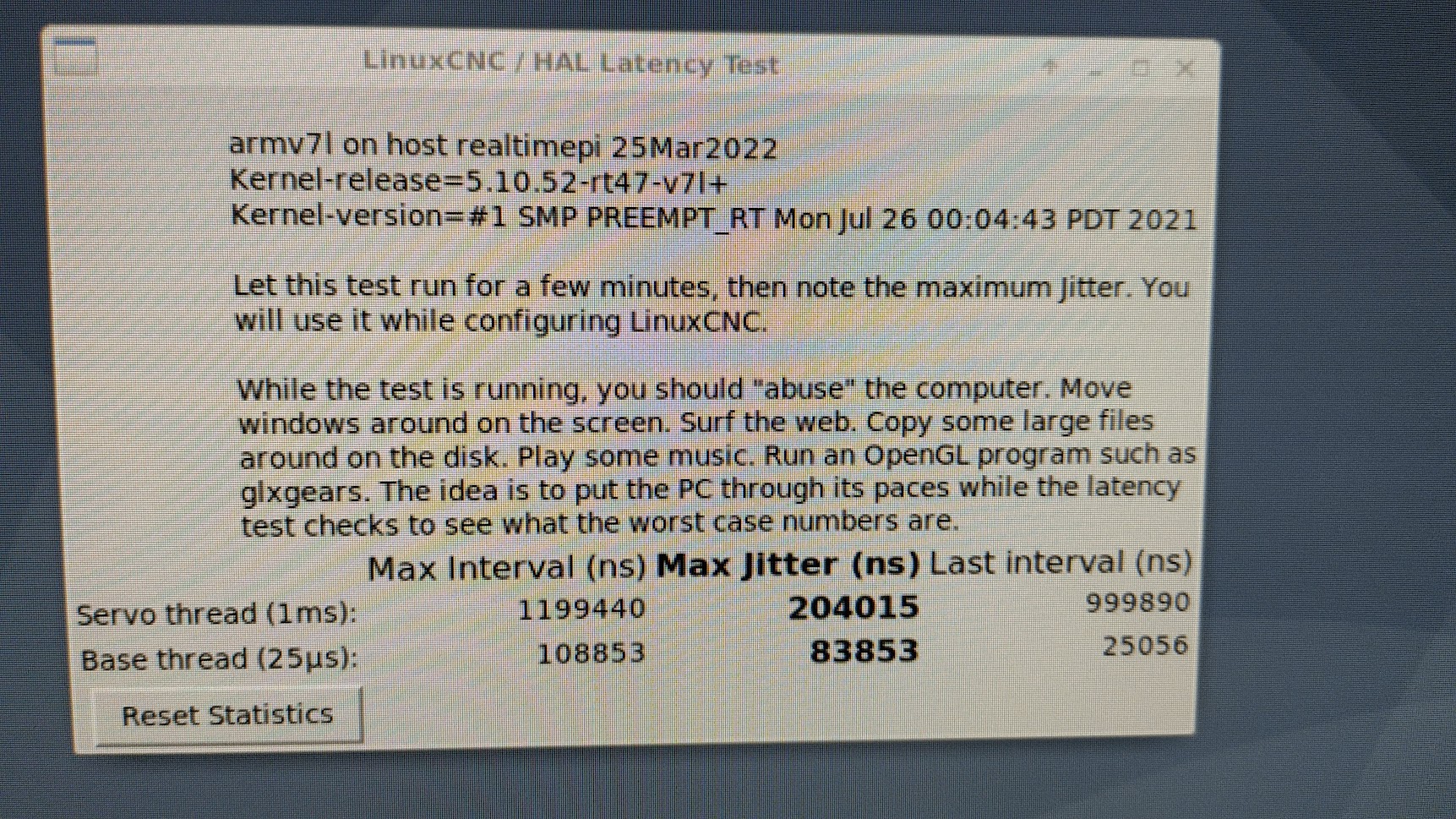

Hy Gents.
Sorry for my late reply... Thank you for your help, Iam on the way to get a system running, but i still have a problem.
1. RPI4 4GB version booted from external SSD trough 3.0USB port. Using this OS: "2021-08-01_2021-05-07-realtimepi-buster-armhf-lite-0.6.0" from unofficialpi.
2. I installed the XFCE desktop with ( xserver-xorg xfce4 xfce4-goodies) .
3. Installing Linuxcnc Uspace from buildbot "linuxcnc-uspace_2.9.0~pre0.6129.g907754aa9_armhf.deb"
4. Then I get this latency
I tried it with SD card ( speed class 10) but the result is worse. Anyway i will use it with 7I76e, so achieve software step generation is not my target.
But i feel something is not working properly. Do you have any idea?
Anywhere in the forum i can see good latency results with RPI4 with realtime kernel combined with Uspace.
Thank You!

Maybe try the SD card image here?
forum.linuxcnc.org/9-installing-linuxcnc...cnc?start=130#238020

Its a bit of a work in progress but there is a 64 bit Raspberry Pi image builder that has decent latency here:
forum.linuxcnc.org/9-installing-linuxcnc...nuxcnc-ethercat-xfce
The image built in this process is good so far.
