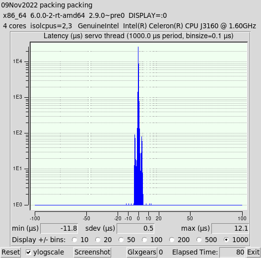

08 Nov 2022 13:58 - 08 Nov 2022 14:03 #256235
So this is the very original Gigabyte N3160 PC I first installed linuxcnc on years ago. It was running Debian Bullseye 5.10 as an office PC for a long time so its had a few upgrades since while struggling with error finishing read which was an issue on it.
I did a full upgrade to Bookworm last night which gave me the 6.0 kernel and lost the network connection. The NIC was not there. I installed linux-headers and that seemed to rebuild the r8168-dkms driver before I did.
INstalled linuxcnc from the bookworm repo. Error finishing read is gone. Latency was around 130k until I added Isolcpus=2,3 Ping times to the 7i76e took quite a hit but Latency is amazing. It was around 0.100 ms before
Time will tell if I need to remove the isolcpus but at this stage everything appears normal.
PS: Also built a RIP install last night which was working too.

Replied by rodw on topic Installing LinuxCNC on Debian 9 - 13
One of the things with isolcpus is the nic interrupt is probably being serviced by the same core as the servo thread which probably accounts for the slower ping times. You can see what cores are used if you type
cat /proc/interrupts
explore the output on the right hand side and you will see the NIC port listed
This old article, I think is useful but I don't think all interrupts go to the one core anymore
www.alexonlinux.com/smp-affinity-and-pro...pt-handling-in-linux
Also this one too:
blog.dan.drown.org/nic-interrupt-coalesce-impact-on-ntp/
BUt it is not supported on my PC
