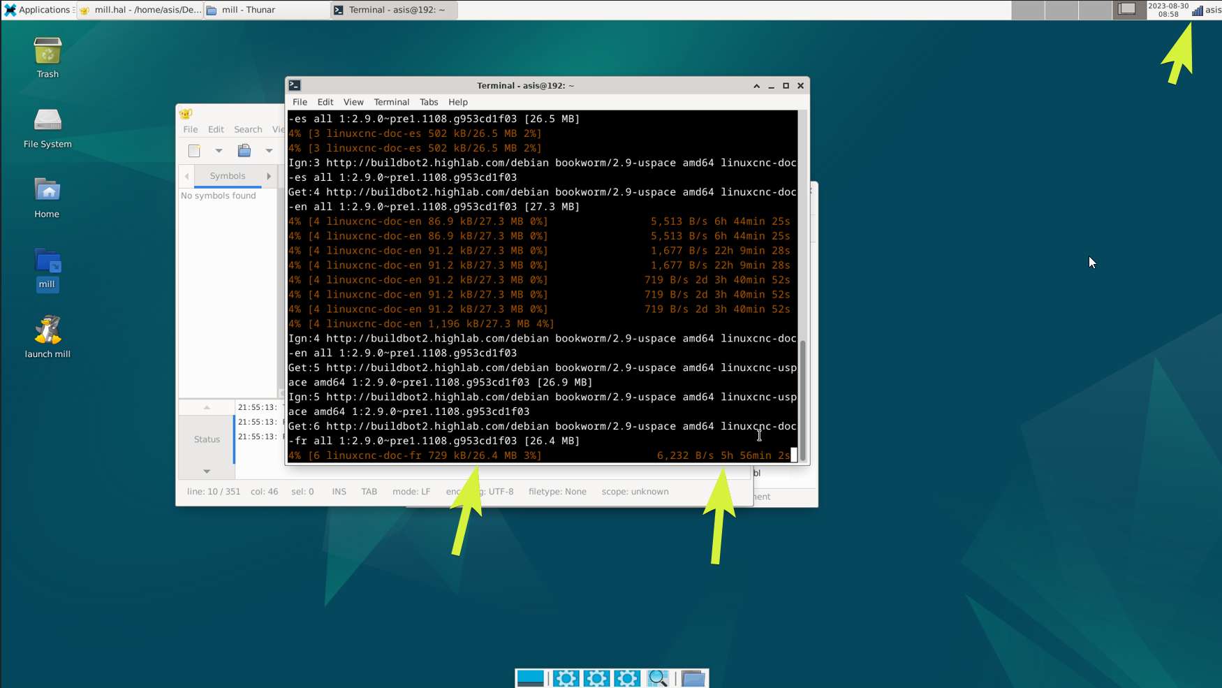

29 Aug 2023 17:57 #279304
by abdulasis12
Replied by abdulasis12 on topic Debian 12 - Bookworm Live installer ISO for linuxcnc (x86_64)
- JPL
- Posts: 337
- Thank you received: 118
29 Aug 2023 18:01 #279306
by JPL
Network appear to be disconnected (top right of the picture), thus cannot reach any server for updates.
Replied by JPL on topic Debian 12 - Bookworm Live installer ISO for linuxcnc (x86_64)
... and below in picture , icon not show picture of shortcut program too....

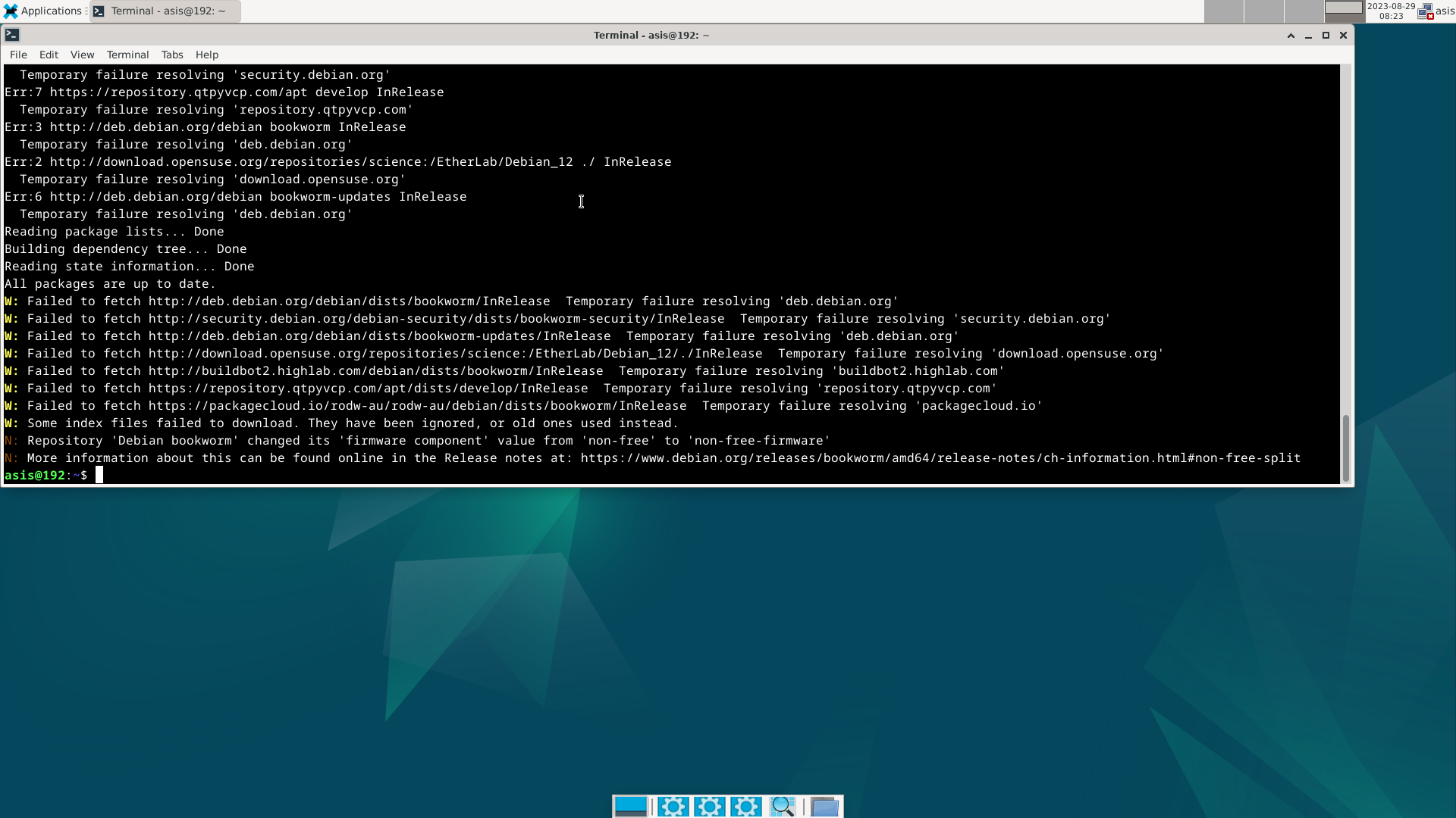

- abdulasis12
- Posts: 133
- Thank you received: 8
29 Aug 2023 18:18 #279307
by abdulasis12
My PC have 2 network
- Pcie wifi card
- Pcie LAN network card
I'm not sure that icon show because wifi not connect but lan connect internet.
I will check again tomorow , will reply soon.
Thank you.
Asis,
Hi mr. JPL
- Pcie wifi card
Thank you.
Asis,
- Posts: 12153
- Thank you received: 4145
29 Aug 2023 21:17 #279319
Replied by rodw on topic Debian 12 - Bookworm Live installer ISO for linuxcnc (x86_64)
You do not have internet.
What PC and What network card in your PC.
There was a regression where non-free non-free-firmware
Was not added to /etc/apt/sources.list
Please: sudo geany /etc/apt/sources.list
and add those words in bold to every line that starts with deb, then updada and upgrade
Its possible that you do not have NIC support which is strange.
