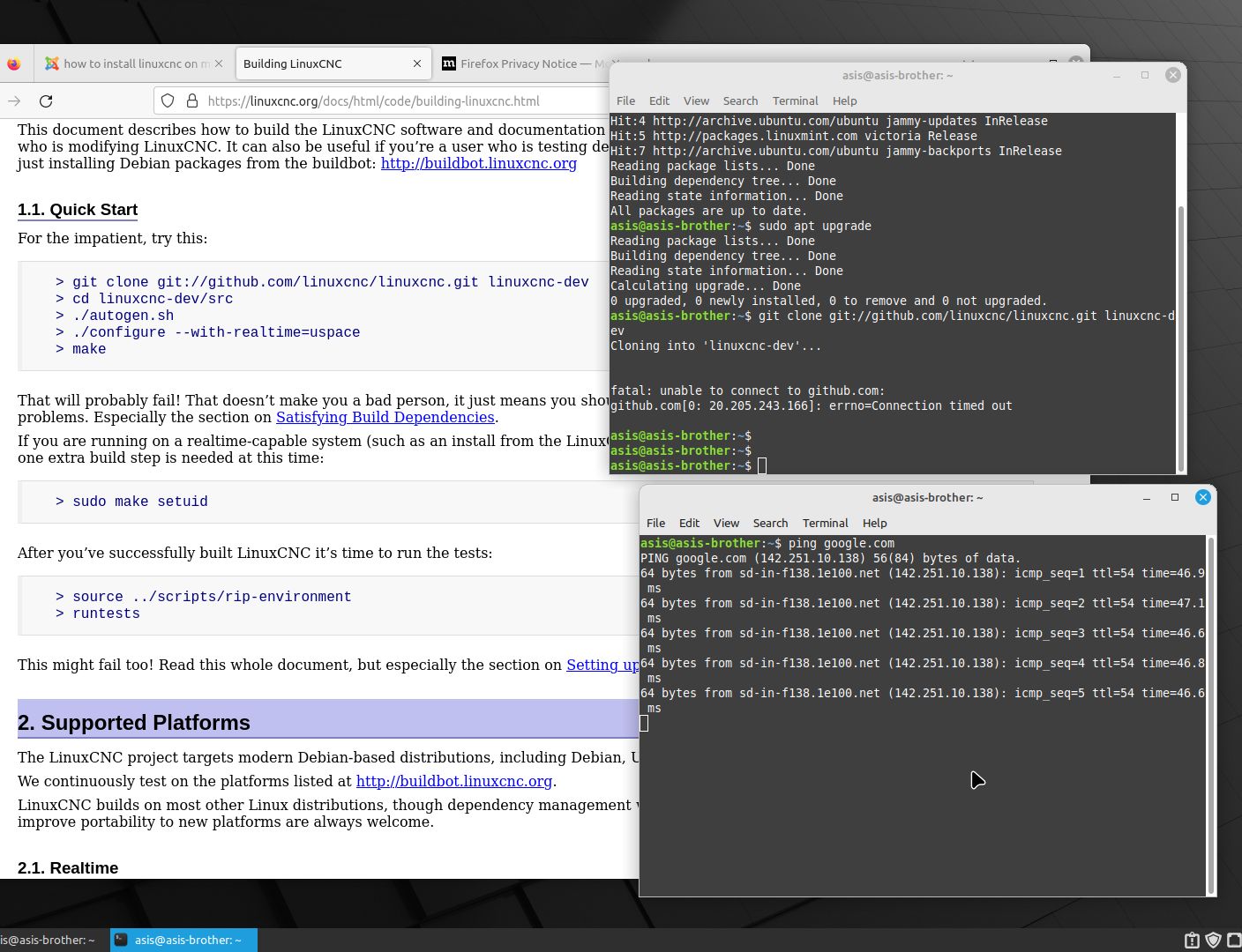

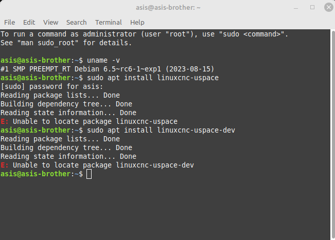

Hi
I'm Asis and Newbie linuxcnc
I just buy 7i96s and read in linuxcnc.org for install
I have problem my Mainboard : MSI Z97 Gamming3 can't boot debian, I try a lot and have new way.
Now I install Mint 21.1 done and can boot up , then I Install Kernal and type uname -v
result now is : SMP PREEMPT_RT Debian 6.5 rc6-1 exp1 (2023-08-15)
then I try install linuxcnc
it's show massage unable locate package .......
what I'm wrong ? and how to fix it ?
Thank you

22 Aug 2023 04:54 #278683
Replied by tommylight on topic how to install linuxcnc on mint I'm newbie
For Mint only this works
linuxcnc.org/docs/html/code/building-linuxcnc.html

22 Aug 2023 06:04 #278686
by abdulasis12
I trybut it's time out, I test ping xxxx.com can reply
Replied by abdulasis12 on topic how to install linuxcnc on mint I'm newbie
thank you for reply ,MR. tommylightFor Mint only this works
I try
git clone git://github.com/linuxcnc/linuxcnc.git linuxcnc-devAttachments:

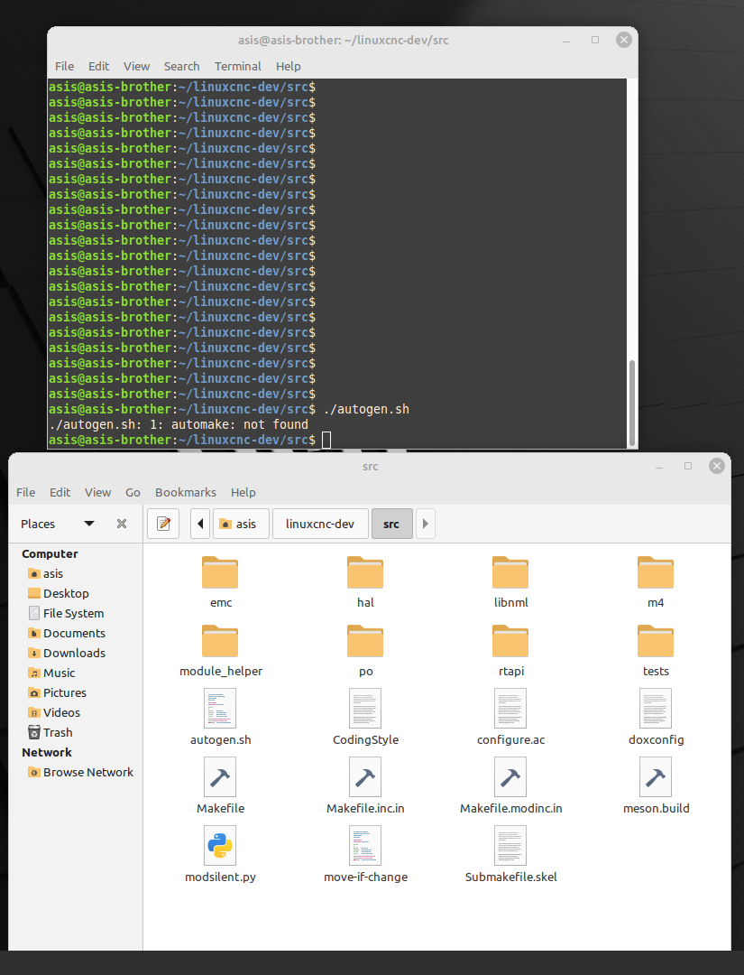

22 Aug 2023 06:17 - 22 Aug 2023 06:19 #278687
by abdulasis12
new update
now I use go to website github/linuxcnc and download file .zip and extract to local folder
I make folder name linuxcnc-dev
I go terminal and type :[/code][/code][/code][/code]
cd linuxcnc-dev/src
[code]./autogen.sh
it's not work [code]./autogen.sh show in picture I have some wrong [code][code] Attachments:

- Posts: 12174
- Thank you received: 4155
22 Aug 2023 06:33 - 22 Aug 2023 06:34 #278688
Replied by rodw on topic how to install linuxcnc on mint I'm newbie
I think it could be made to work if you follow #9 in the 2.9 getting linuxcnc docs. and added the linuxcnc rules. you may not need the file starting with 99 as clearly linuxcnc is not in the repos from your error

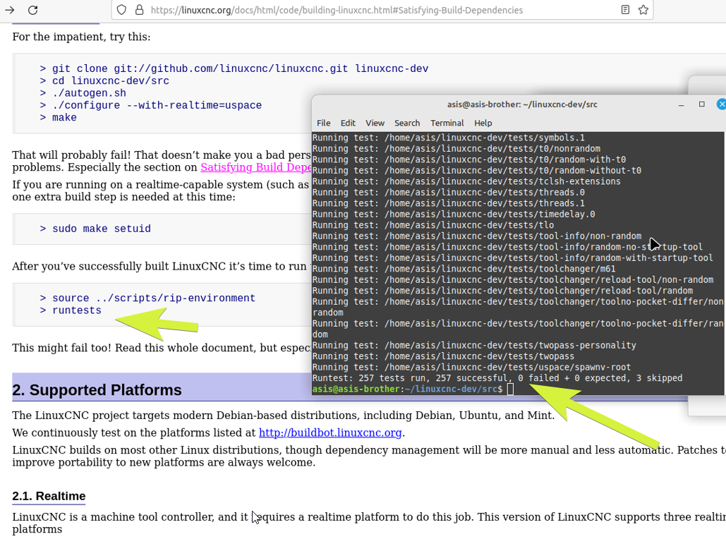

- abdulasis12
- Posts: 133
- Thank you received: 8
22 Aug 2023 08:23 #278701
by abdulasis12
First, Thank you for all reply
Now seem I finished install LinuxCNC
I can
how to open program linuxCNC ?
Its no Icon or somethink for open prgram , haha sorry I'm Beginner LinuxCNC
I can
> source ../scripts/rip-environment
> runtestshow to open program linuxCNC ?
- Posts: 4819
- Thank you received: 2177
22 Aug 2023 08:39 #278703
Replied by Aciera on topic how to install linuxcnc on mint I'm newbie
$ linuxcnc
Note that every time you start a new terminal you have to cd to ~/linuxcnc-dev and run
$ source scripts/rip-environment
