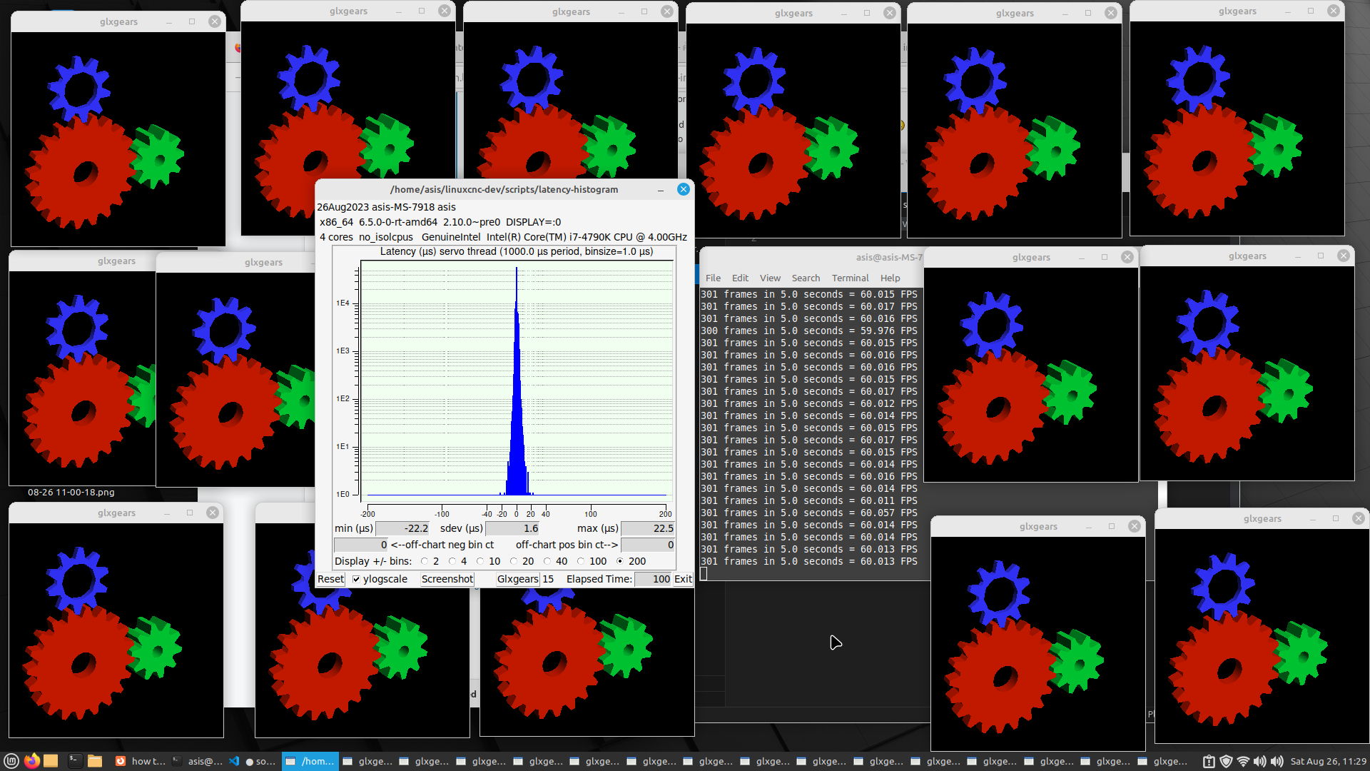

25 Aug 2023 23:39 #278984 by abdulasis12
Replied by abdulasis12 on topic how to install linuxcnc on mint I'm newbie
STOP.
Do a latency test first:
latency-histogram --nobase --sbinsize 1000 --show
Did you disable stuff in BIOS as noted before.
Hi
I'm action:
go to BIOS
hyperthreading = disable  (before action is enable)
speed step = disable   (before action is enable)
turbo = disable    (before action is enable)
power saving  = not see
Virtualisation. = not see or can't  on off
below this result
