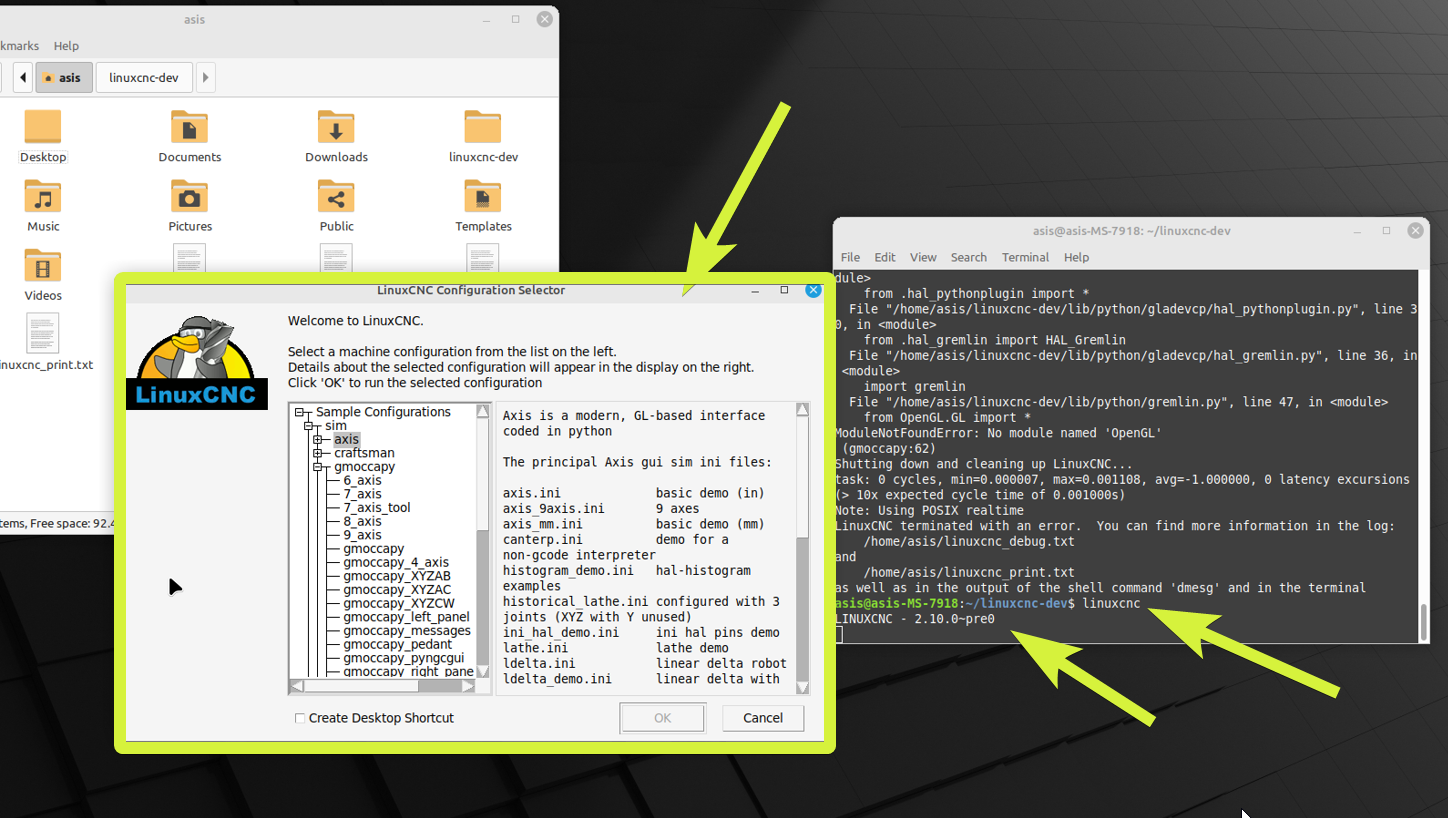

Replied by Aciera on topic how to install linuxcnc on mint I'm newbie
In the config selector select 'Sample Configurations/sim/gmoccapy/gmoccapy' and click the OK button. This should open a 3-axis simulation configuration with gmoccpy gui.
To setup a real machine running on parallel port run:
$ stepconf
for mesa board:
$ pncconf
[edit]
to open linuxcnc with the last used configuration you can use the -l option (lowercase L):
$ linuxcnc -l

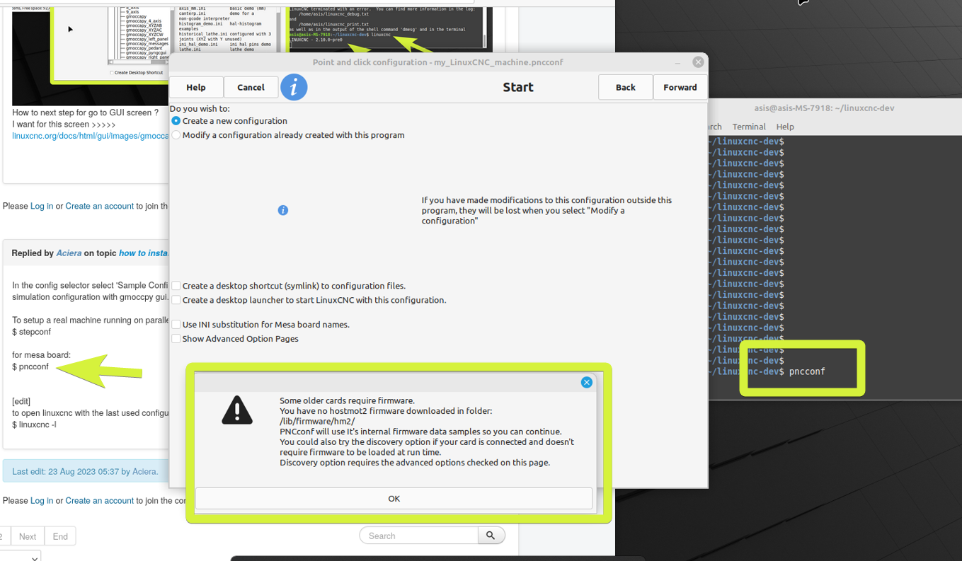

23 Aug 2023 01:34 #278749
by abdulasis12
Now I type in terminal
$ pncconf
then show GUI for create config
I choice create a new configuration
then click button forward.
its show popup "no hosmot2 firmware downloaded in folder:/lib/firmware/hm2"
I need to download it how to ?
Asis,
This is only required for older mesa boards, so you can probably ignore that message and continue by clicking ok then you should be able to start to set up a new configuration

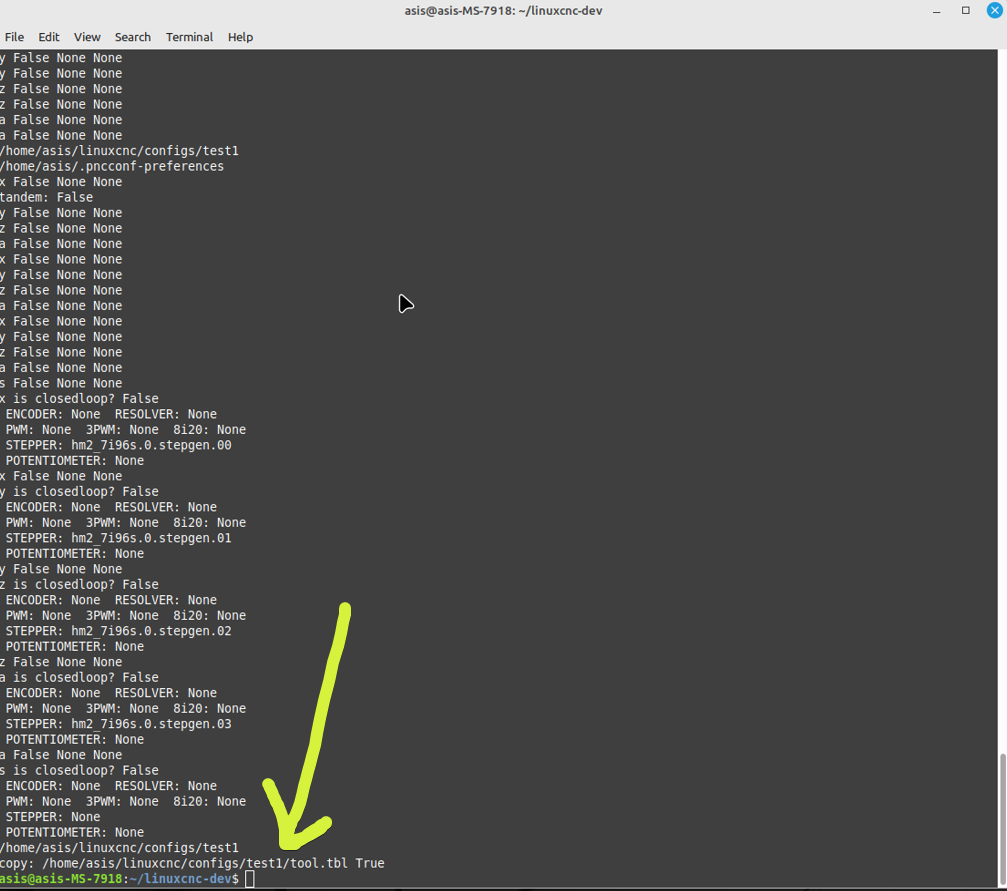

23 Aug 2023 02:45 - 23 Aug 2023 02:49 #278752
by abdulasis12
Now I go to config .
I create in name test1
all done .
the GUI config force close, and Terminal show
copy: /home/asis/linuxcnc/configs/testl/tool.tbl True
give for next step for open GUI linuxcnc

23 Aug 2023 03:10 #278753
try:
$ linuxcnc /home/asis/linuxcnc/configs/test1/test1.ini

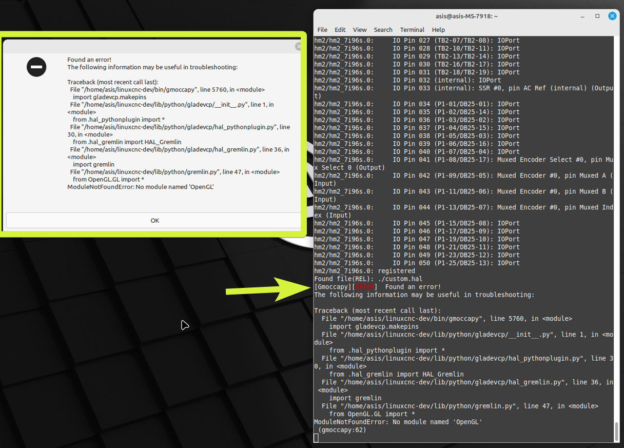

23 Aug 2023 03:59 #278755
by abdulasis12
and it's show this in new pop-up
Found an error!The following information may be useful in troubleshooting:Traceback (most recent call last):File "/home/asis/linuxcnc-dev/bin/gmoccapy", line 5760, in <module>import gladevcp.makepinsFile "/home/asis/linuxcnc-dev/lib/python/gladevcp/_init_.py", line 1, in<module>from .hal_pythonplugin import *File "/home/asis/linuxcnc-dev/lib/python/gladevcp/hal_pythonplugin.py", line30, in <module>from .hal_gremlin import HAL_GremlinFile "/home/asis/linuxcnc-dev/lib/python/gladevcp/hal_gremlin.py", line 36, in<module>import gremlinFile "/home/asis/linuxcnc-dev/lib/python/gremlin.py", line 47, in <module>from OpenGL.GL import *ModuleNotFoundErfor: No module named 'OpenGL'
then I click [OK] it's forced close pop-up and back to terminal.
Try:
pip install pyopengl
[edit]
You may have to install pip first:
sudo apt install python3-pip

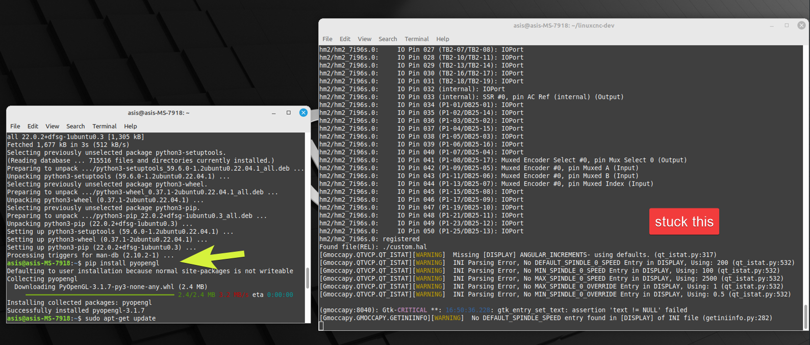

23 Aug 2023 04:55 #278766
by abdulasis12
I go terminal and type....now it's stuck on this screen
Replied by abdulasis12 on topic how to install linuxcnc on mint I'm newbie
Ok now I install python3-pip and then pip install pythongl done.Try:
[edit]
$ linuxcnc /home/asis/linuxcnc/configs/test1/test1.iniAttachments:
