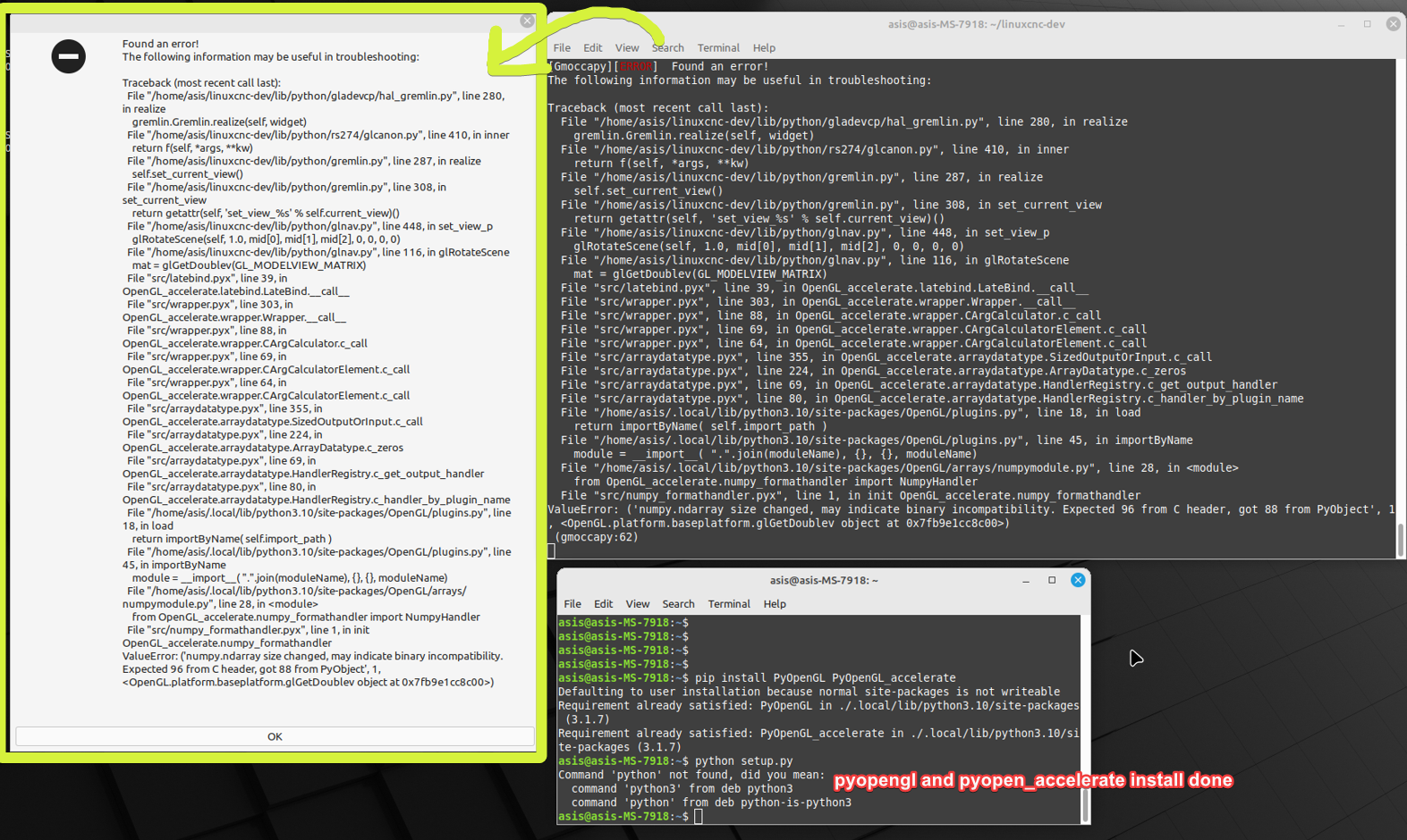

23 Aug 2023 05:02 #278768 by rodw
I think your case is wrong. REF: pyopengl.sourceforge.net/
23 Aug 2023 05:29 #278772 by abdulasis12
Replied by abdulasis12 on topic how to install linuxcnc on mint I'm newbie
Thank you MR.Rodw
Now I Install
$ pip install PyOpenGL PyOpenGL_accelerate
Done.
then again to terminal and type :
$ linuxcnc /home/asis/linuxcnc/configs/test1/test1.ini
result is this picture >>>>>
have big popup show some error
23 Aug 2023 05:56 #278775 by Aciera
Replied by Aciera on topic how to install linuxcnc on mint I'm newbie
Try:
pip install --upgrade numpy

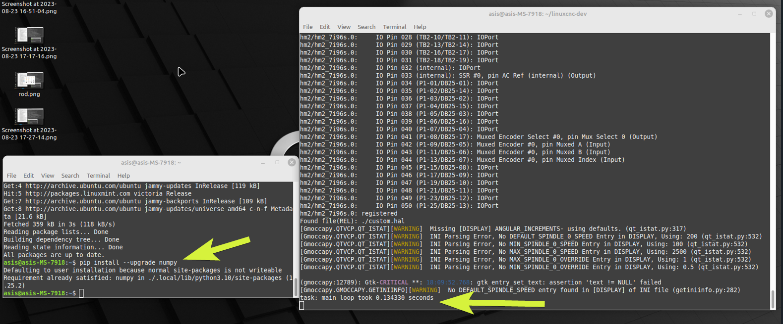

23 Aug 2023 06:26 #278779 by abdulasis12
Try:
I type
and back to try
stuck this

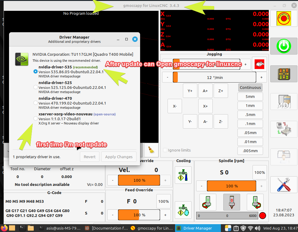

23 Aug 2023 06:54 #278783 by abdulasis12
As for the OP, when you start Axis gui, if you get a missing OpenGL error, change the graphic card, or you will have to go back to software rendering, that on new Debians is very hard to do, if not impossible.
Thank you MR.Tommylight
I try to go check driver ghraphic it's not update.
I try update and reboot
After reboot my monitor change from max 1920  to 1024 and can't to back to 1920
but, can open gmoccapy for linuxcnc
thank you.
Have any method for change my graphic back to 1920 ?
23 Aug 2023 07:29 #278786 by Aciera
and back to try$ linuxcnc /home/asis/linuxcnc/configs/test1/test1.inistuck this
That warning should not block linuxcnc from starting up, I get that on my linuxmint 21.1 machine as well. Also you seem to be able to run the simulation just fine. Can you attach your test1.ini and test1.hal files please?

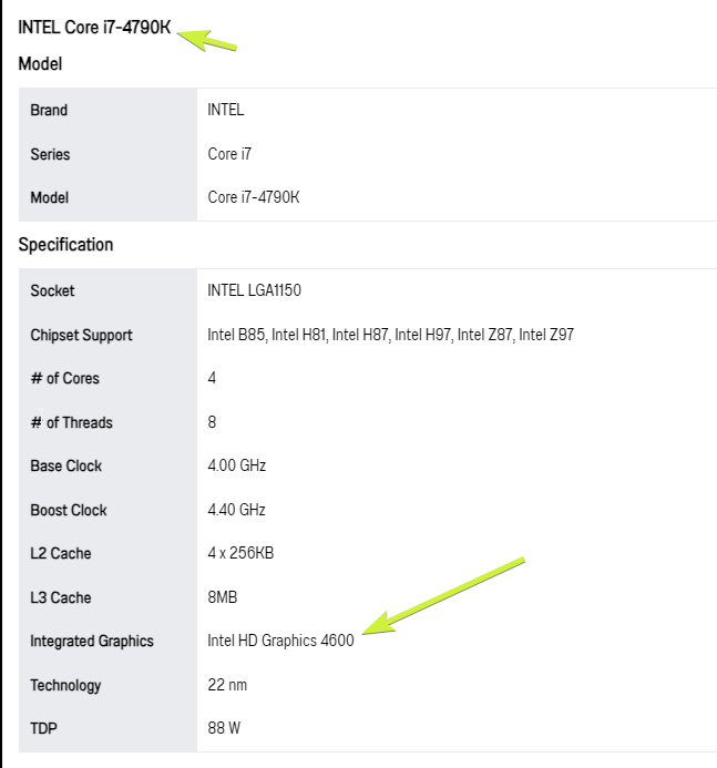

23 Aug 2023 10:00 #278798 by tommylight
Replied by tommylight on topic how to install linuxcnc on mint I'm newbie
Nvidia graphic cards with proprietary drivers do not work with Real Time kernel, and subsequently LinuxCNC.
Revert back to using Nouveau/xorg drivers.
Had the same issue a while back with a GTX960M graphic.
23 Aug 2023 11:36 #278805 by abdulasis12
Hi, MR. Aciera
After I type from you
and can't to open my linuxcnc program
then MR. tommylight say about graphic card.
I try check driver and have update driver.
I try update and restart
then try
It's work !!! , Thank you for help me.
But after driver graphic update my resolution screen change from 1920 down to 1024 when open linuxcnc lower button will drop out screen .
tommylight say "drivers do not work with Real Time kernel" , maybe tomorow I will try remove Nvidia graphic card and use internal GPU
