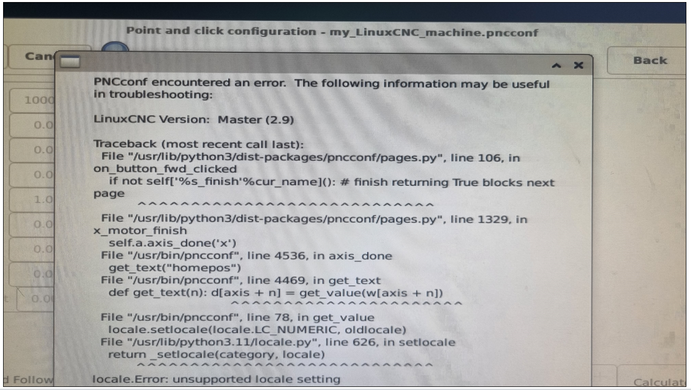

Was also able to successfully open the Pncconf tool, and select mesa 7i96s,
Can complete the forms but get error on the screen where you select stepper drivers and calculate sterpper scales.
PNCconfig encountered an error. The following information may be usefull in troubleshooting: ..... [screen shot attached]
“locale.Error: unsupported local setting. Not sure if this is a issue with the build, Pnconfig tool, or me not doing it correctly.

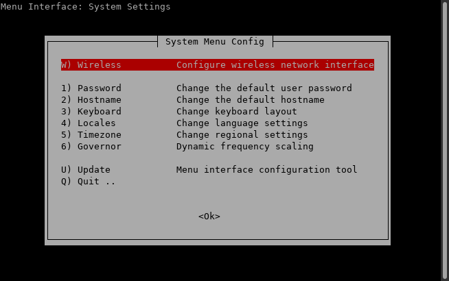

i flashed the new version onto raspberry and also ran the menu-config tool where is selected a "local" en_US.UTF-8 now i am no longer getting the errors on PNCconf and can configure with it.
Thanks a million rodw

Great,
The locale is set in the installer to en_US.UTF-8 so I don't know what is happening threre. Did you notice what it was in menu-config?
