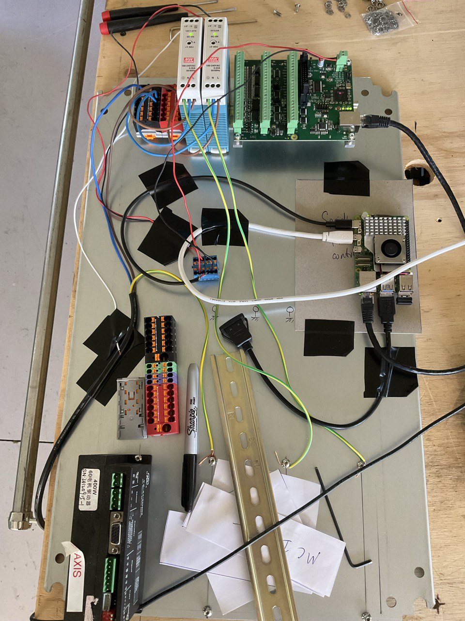

The good news is that the RPi and Mesa 7i96s are communicating and appeared to be doing so reliably using the Dragon GUI until a string of these messages appeared:
hm2/hm2_7i92.0: error queuing read! iter=xxx
hm2/hm2_7i92.0: error finishing write! iter=xxx
If I run the following, there appears to be dropped packets:
sudo chrt 99 ping -i .001 -q 10.10.10.10 /* forum.linuxcnc.org/27-driver-boards/4837...rite?start=20#266420 */
About 25% were dropped when using a 30 cm CAT cable (not sure what type, shown in photo above). Changing to a longer CAT 5e cable resulted in a tiny percentage of dropped packets. Nevertheless, the errors keep appearing when running Dragon GUI -- I'm not suggesting that Dragon GUI is the issue here.

- Posts: 12166
- Thank you received: 4152
13 Feb 2024 09:28 #293208
Replied by rodw on topic LinuxCNC on Raspberry Pi 5
Its a hardware issue. please read my tutorial here
docs.google.com/document/d/1jeV_4VKzVmOI...diY/edit?usp=sharing

- Posts: 12166
14 Feb 2024 00:02 #293279
Being new hardware, its possible you are a victim of enegy efficient ethernet.
ref: www.juniper.net/documentation/us/en/soft...e%20link%20is%20idle.
Could you try disbale it by adding
igb.EEE=0
to your boot parameters (where you put isolcpus) I think its boot.txt on the pi
I have no idea if this will work!
