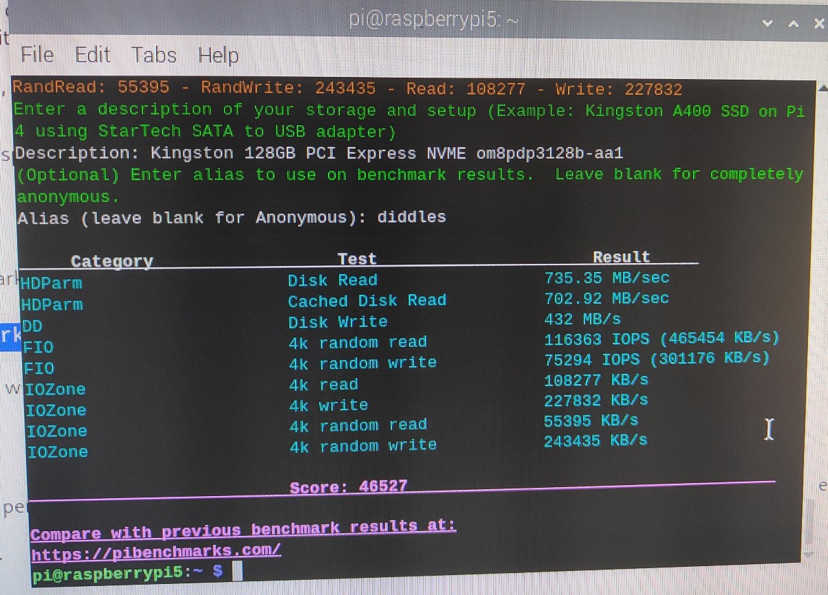

20 Feb 2024 22:15 #293863
by flyingbrick
Replied by flyingbrick on topic LinuxCNC on Raspberry Pi 5
I purchased from pimeroni themselves.
SD cards are SLOW. The Pi5 feels snappy compared to the Pi4 and some older PC's but the NVME drive completely changes the game.
PS, SD cards have write speeds of something like 30mb/s and read of 90 mb/s. (varies greatly depending on SD card)
With my NVME (which is just a used laptop one that i got for $5) and the pimeroni hat, I get 432mb/s write and 735mb/s read.

20 Feb 2024 22:19 #293866
by flyingbrick
- Posts: 21957
- Thank you received: 7478
20 Feb 2024 22:25 #293867
Replied by tommylight on topic LinuxCNC on Raspberry Pi 5
NMVE drives can do up to 7GB/s of read and write, but those are pricey, and i do not know what RPI5 uses to access it, but 700MB/s is still a bit faster than the fastest SSD, so very good for the price.
