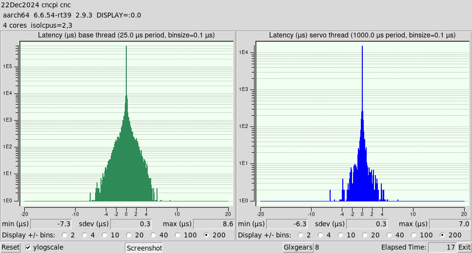

I finally feel like my basic Pi5 (NVME boot) / Mesa 7i95T system is basically functional.
I used Rob's link to what I think is his Google Drive to get what I believe is a LinuxCNC 2.9.3 / Kernel 6.6 RT ISO.
Because of being new or very rusty on virtually every level, I wound up stumbling my way through that process relying on the gracious help from the community.
I will attach a number of files for anyone to glance at or comment on if they wish.
Since I know now that there are many choices I should do differently I ordered an inventory of NVME and SD cards to start over clean and also try out other combinations of options without abandoning what I have.
I have a few questions before I start over 'clean':
1) Is the Pi5 2.9.3 ISO that I downloaded (or a newer one) now attached to the link on the Downloads page or is the one I downloaded still the latest?
2) I installed NetworkManager because I was struggling getting my WiFi working for internet access while dedicating the cable Ethernet to the Mesa board. Would it be better for me to avoid NetworkManager this time around?
3) I installed the Raspberry KVM because I thought that it might be useful sometimes, but I have never really used it so far. I'm wondering if there might be some latency implications to its presence or use?
I also included a screen capture for the latency histogram if anyone is curious.
