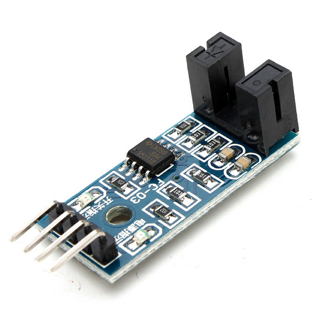

Hi One problem solved and one remain ,I replaced the analog optical sensor to a "digital" one and the revolution meter start to work . the reading is ok and the reading is controled with a speedometer. the other problem is the red and green LED weryfing to start the process from the G-code program G97 S600 M3 The program start at 150 rpm and the red LED starts at 350 rev, it is mirror action , it should start at ca 450 and stopp at ca 700 revs ,it is programd with 150 % tolerans .
