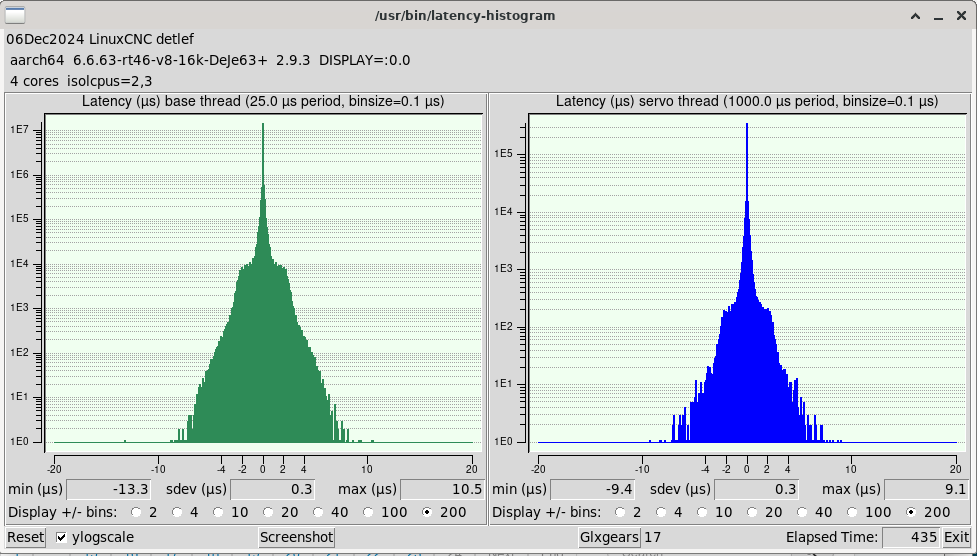

06 Dec 2024 12:54 #316094 by Deje63
Replied by Deje63 on topic LinuxCNC on Raspberry Pi 5
I would say in general it is not hard to setup, you need to know how. wink
I got it finally working very well with very low latency on my RPI 5
short description:
- take Raspberry OS 64bit Lite
- install Xfce4
- build the RT kernel the usual way
- install it
- install linuxcnc
It takes some time on the RPI.
As I am writing this in Firefox on this machine, latency-histogram (was started befor starting Firefox!) is running and 17 glxgears.
To be honest, so far I am very happy with. :D
Attached please also find a somewhat "script" to build from scratch.
The following user(s) said Thank You: fletch, KrisJ

07 Dec 2024 08:30 #316165 by Deje63
I do not see Images for LinuxCNC 2.9.3 on the Download page, am I blind?
With the ones provided I ended up in 640x480 display resolution, no idea why. But I could not use it.
To me, this is a big difference. ;)
btw. build time is no issue on the RPI5.
