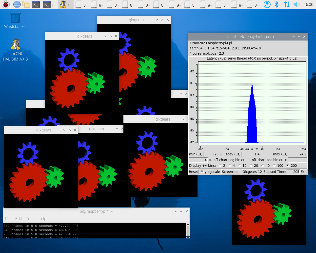

Then I added "isolcpus=2,3 max.processor.cstate=1" to /boot/cmdline.txt (for latency issues)
Installing Linuxcnc can be done easily with the LinuxCNC installer script
www.linuxcnc.org/linuxcnc-install.sh
The result of the latency test (latency-histogram --nobase --sbinsize 1000 --servo 40000)
is the following

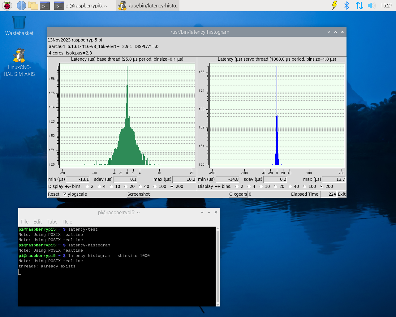

To prepare a version of Raspbian 12 for Raspberry Pi 5 with PREEMPT_RT I used the script reported here
forums.raspberrypi.com/viewtopic.php?p=2145335
appropriately modified to take account of the patch, taking into account the indications given here
github.com/kdoren/linux/wiki/Building-PR...nel-for-Raspberry-Pi
I used the Linux Kernel is 6.1.61 while the RT patch used is the one for 6.1.59-rt16
The procedure produced no errors and therefore I installed the OS on a new microSD containing the new Raspbian 12
Also in this case installing Linuxcnc can be done easily with the LinuxCNC installer script

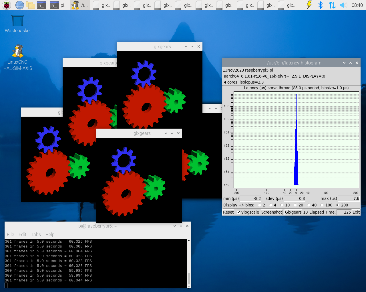

I then ran the command "latency-histogram --nobase --sbinsize 1000 --servo 25000". the value 25000 of the servo parameter is the minimum value allowed by the procedure
The results are definitely surprising

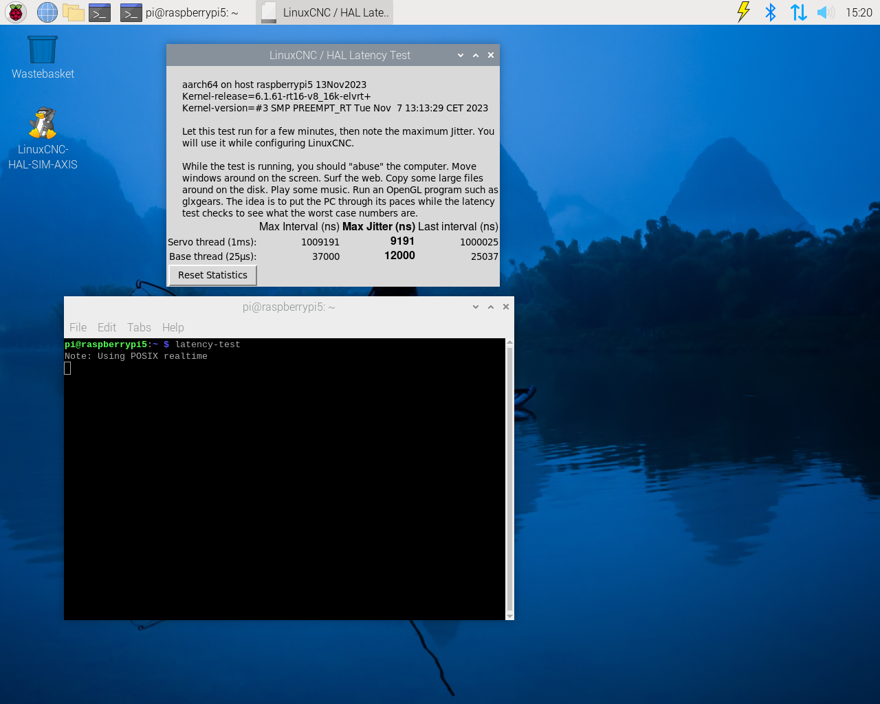

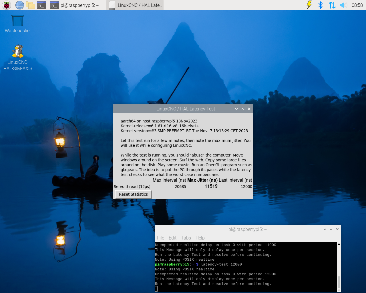

I tried the latency test here with smaller servo values.
The lowest value that did not show the "Unexpected realtime delay" message was
latency-test 12000

What latency are you getting running a servo & base thread ?
- elovalvo
- Posts: 205
- Thank you received: 127
13 Nov 2023 08:43 #285264
by elovalvo
Result of latency-histogram
Replied by elovalvo on topic Comparison between Raspian 12 Bookworm on Raspberry Pi 4 and Raspberry Pi 5
Result of latency-testWhat latency are you getting running a servo & base thread ?
The following user(s) said Thank You: tommylight, Cant do this anymore bye all, flyingbrick
